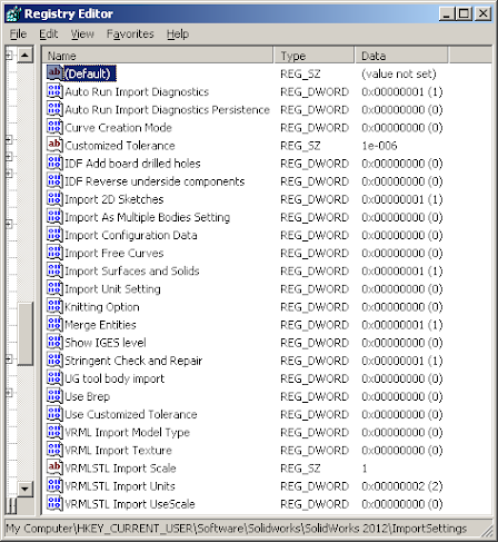

Sometimes we get imported geometry from our ID guys that use Rhino. We edit these files in SW for manufacturing feasibility. We recently had a part that whenever we tried to edit it we would get the "Feature Failed to Cut the Body" or "Geometry Error" messages. I went to a co-workers computer to have him try to edit the part, and he had no errors, so I copied his settings (Copy Setting Wizard) over to another machine that was having the errors, and it can now edit the part without any problems.
I have left my machine as "the control" and am comparing all the settings, but I cannot find any differences. Do any SW Gurus here what I should be looking for? It's very possible that I have overlooked something, somewhere.

Are you thinking that maybe screwing up both computers could lead to MadMango and his compatriot both getting new High End Workstations?
At least MadMango didn't take the Reinstall route typically copy settings will fix most problems for identical machines and many times for different ones.
For a cheaper investigation you can do a file compare of the .sldreg or what should be (or actually is .reg as you'd get with using regedit) using msWordd, excell or Textpad.
Registry location
MyComputer\HKEY_CURRENT_USER\Software\SolidWorks
You can use (Favorites > Add to favorites) to save it for easy access from the regedit pull down menus.
MyComputer\HKEY_CURRENT_USER\Software\SolidWorks\SolidWorks 20##\ImportSettings.
Save off your settings and try the option to reset all settings to SolidWorks Defaults and try that next.
