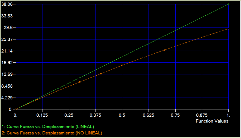

I am currently learning NX Nastran and I am trying to perform an analysis of a pressure vessel I have designed. I have been using SOL 106 - Global Constraints and have got some results, but it took about 6 hours to run. So my question is, is SOL 106 the best alternative? How would you set up the analysis?
I used fixed constraints on the pressure vessels support legs, internal pressure 1.1 MPa, and surface-to-surface gluing between the main body and the two end caps. Part file attached.

The important file is the *.modfem FEMAP model, more than the *.prt geometry file, then we will see the meshing aproach used to mesh the vessel.
The Nonlinear solver (SOL106) is always the exact solution (real life is always dynamic transient & nonlinear!!), of course, but it could have an important cost in both solution time & hardware resources, so I strongly suggest to run FIRST always a linear static (SOL101), evaluate results of both displacements & stress, and judge if a nonlinear analysis is required. If you have displacements results of the order of the pressure vessel thickness, then please run a nonlinear analysis, because linear static analysis do not account for stiffening effects due to inplane loadings: the way that tensile mebrane stress increases the bending stiffness is computed by nonlinear analysis only.
Here you are a simply vessel example solved with FEMAP & NX NASTRAN as linear & nonlinear (considering only large displacements effects geometric nonlinearity), comparing both solutions of displacement results vs. load you will realize the level of nonlinearity of the problem:

1.- Please, do not use solid tetraedral elements to mesh a vessel, Shell 2-D elements will give you extremely better results, perform a midsurface extraction in order to mesh with plate elements. If required to use solid edlements, please note you need at minimum TWO elements in the thickness, then the solid hexaedral CHEXA elements are preferred.
2.- GLUE surface-to-surface contact is designated to joint opposited surfaces, not the exterior faces of two solis, you have defined a contact Region 1 the outer surface of the cylindrical vessel and Region 2 the outer surface of the conical part. This is not correct, you need to define REGION 1 y 2 preciselly the contact faces of both cylindrical & conical parts.
3.- Your TET mesh is terrible distorted, you will arrive to useless results ...
