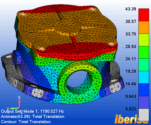

Here you are an example of modal analysis of an assembly with NO contact between components.
And here you are the same model solved using bolt-preload + surface-to.surface contacts plus also node-to-node explicit contact CGAP 1-D elements to take in aaccount the contact with a rigid floor:

Clear, OK?. Now to the bolts: the typical use of bolt pre-loading is to joint two plates in contact, then this is the reason why you need to define and include surface-to-surface contact between plates in your analysis, the above explain you how to do it.
The NX Nastran approach for bolt preload is very efficient because the entire run is automated allowing for direct entry of the bolt preload forces. During the run, the model is solved twice. The first solution calculates the deformed shape of the bolted medium resulting from bolt preload forces. The software then performs an intermediate calculation. The appropriate compressive forces to apply to the bolts during the second solution are calculated correcting for differences in the length of the bolt model and the loaded length of the actual bolt. Solving the model a second time gives the stress state resulting from bolt preload forces and, optionally, service loads. Bolt preload is supported in SOLs 101, 103, 105, 107 through 112, and 601.
Contact Definition
When a contact definition exists, the contact conditions are included in both solutions. To decrease the solution time, the second solution begins with the contact status from the end of the first solution. As a result, the contact element creation steps and some of the initial contact iterations are avoided in the second solution.
The above demostrates that NX NASTRAN (SOL103) can solve problems with both bolt-preloading and also surface-to-surface contact.
Now to NX Advanced Simulation: In an "SEMODES 103" solution, bolt preload can be added either in 'Static Offset' or 'Stress Stiffening' subcases only. Either one of these 2 subcases should be made active in order for this command to be available. This will add STATSUB = 1 in the case control section of the nx nastran input.
