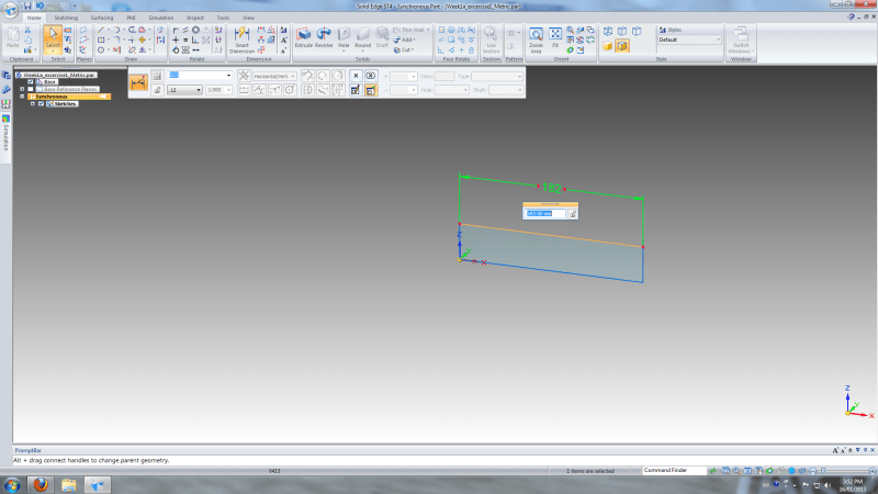

I'm unable to change dimensions after I've created something in solid edge.
For example, I drew a rectangle using the line tool, after it's been created, using smart dimensions, I'm unable to change the dimension of the rectangle. If I change the numbers in the box, it simply says dimensions aren't to scale. I've attached a screenshot of the issue, as you can see, you can't even click on the lock beside the dimension, it's grayed out.
thanks in advance for the help!
RE: Can't modify dimensions
You might want to try enabeling dynamic edit in Solid Edge options > General
