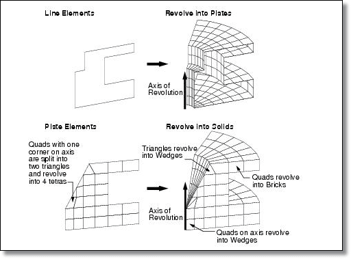

I am trying to revolve parabolic elements on a plane surface in FEMAP 10 but because the elements lies on the axis of revolution it doesn't create the wedge type elements at the axis of rotation. If I revolve linear elements it work fine but i don't get a smooth round revolve that i would get with midside node
Any idea?

1.- Revolve 2-D linear elements using "Mesh > Revolve > Element" command, and then convert to high order using "Modify > Update Elements > Linear/Parabolic order", or
2.- A better meshing approach is instead revolving elements around Z-axis, why not create a quality 2-D mesh of the circle based in QUAD elements, and then to extrude the 2-D mesh to create a perfect 3-D HEX mesh avoiding triangular wedge elements?. Also, this way your 2-D mesh could be parabolic, so not any limitation exist -- enjoy!.

suggestion 1) if you revolve with the linear element the revolve is not curve but has straight line between the nodes. [http://files.engineering.com/getfile.aspx?folder=b...]
what i am looking for ir more like the blue line here [http://files.engineering.com/getfile.aspx?folder=f...]
Sugestion 2) Unfortunalty the picture i sent posted were just a basic model for a more complex model witch the extrude feature would not work, here is a picture of the model http://files.engineering.com/getfile.aspx?folder=d...
