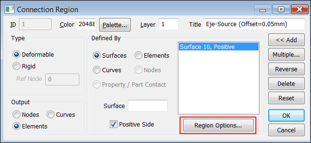

Blas...thanks for all that info....very helpful...regarding the use of the offset...will that need to be declared on the slave and master or just the slave or just the master surface?
thx,
scott

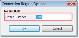

also, is there anything specific (or special) that needs to be done to the connection properties?
RE: Contact problem
Dear Scott,
There are two contact region parameters which can be used in linear solutions, the SURF and OFFSET fields.
• SURF is used to define the contact side of shell element regions, not of interest in this case.
OFFSET field allows to account for a rigid layer which might occur between two faces coming into contact. For example, a model which has two metal surfaces coming into contact, and one of these has a ceramic coating. If the ceramic material stiffness is not significant enough to be included in the analysis, it may not have been specifically modeled, but the thickness it adds to the face of the metal may be important when considering the contact problem.
You can also use the OFFSET field to analyze an interference fit problem if unconnected elements are modeled coincident. The offset value in this example can represent the theoretical interference of these faces.
Apply the OFFSET in the SOURCE region.
