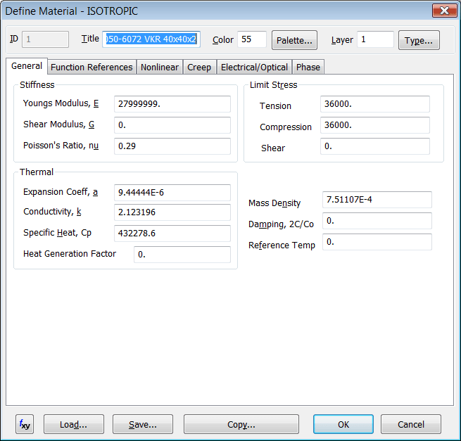

Please check your model, investigating the material properties used I see some incoherence in units, in the following material property the YOUNG MODULES is defined in PSI units, then a mixing properties of PSI & MPA exist in your model. Please check that dimmension units are correct, etc.. if not the results maybe useless ...

Thanx you so much for taking the time to help me out here. I saw that the material properties for beams was incorrect... simple fault because of fast modelling. Anyway, that doesn't change anything even if I adjust to correct units. If you think about another way; the pipe is just 60,3 mm in diameter meaning that the stresses will not be so high by the internal pressure of 12 bar (1.2 MPa).
