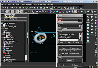

Right Click the Feature in your Model Tree You can add Notes to a Feature as a comment or Add text within the sketch and make it construction geometry but the latter is a way messier method and Construction cannot be set to the Text so scratch that method.

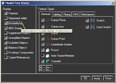

You cannot add or edit the comment while editing the sketch but after you hit the Check button to finish the sketch you can go back and add notes. Go into your tree filters (which control what shows in the tree) and add notes.
This is the method to get what you want however it is not necessary to Attach it to geometry, you can leave the Note unplaced. by just hitting OK or can place it flat to screen and make a separate layer to control display of only feature notes instead of showing all or no annotations.
