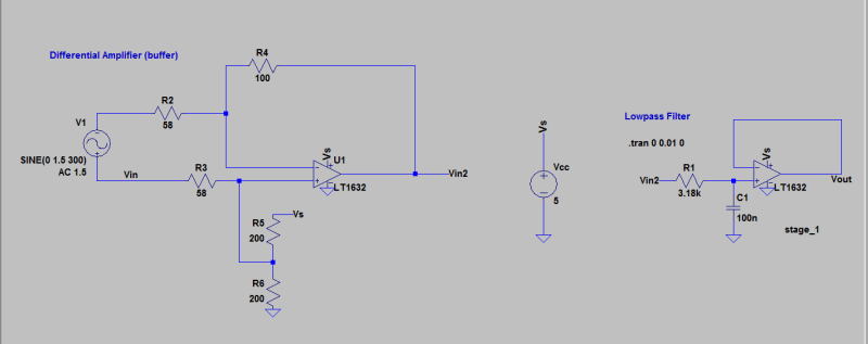

Well I want the final product to be able to take in any audio signal regardless of the source and analyze it in real time so on-board source signal processing is not going to be an option. As far as DC biasing is concerned, I am currently utilizing a differential amplifier to accomplish this and that is working as of now, but I am having trouble achieving the gain, bias, and filtering combination.

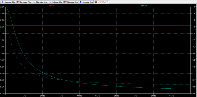

Here is the schematic of my low-pass filter which is off-phase and not properly amplified. Also there is a little bit of noise:
Schematic
AC analysis

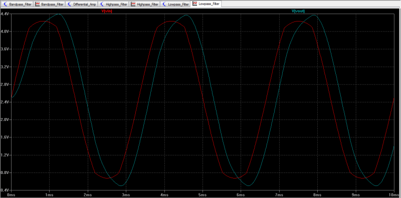

DC transient response
Any suggestions on how to get rid of the noise and bring the output in phase with the input signal?
RE: Help designing analog filter designs for an audio activated 8x8x8 LED cube
Your low-pass filter doesn't work. The impedance at the inverting input of the opamp is zero. You need at least a T network. Better still a multi-pole filter. Read up on basic opamp circuits and analogue filter design. You are not on designer level. You need lots and lots of more education. You cannot get it here. It needs some work from you.
