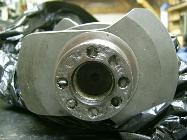

At least up until the 80s Not many passenger cars use anything but clearance fitted (despite what was published on the ARP site for a while) bolts to clamp the flywheel to the crankshaft, and cantilevered bolts/studs to hold wheels to axle flanges against torsion and sometimes even radially. For the last 3 score years a willing army of 16-24 year olds have been trying their best to violate the flywheel/crank joints' integrity and wiggle the wheels free of the axles in various creative ways. I've only known of 2 flywheels to loosen, and each time it was confirmed a torque wrench ( boo, hiss, useless, evil) was NOT used to tighten things up. Wheels sometimes loosen, but my experiences suggests those originate from installation deficiencies, not design deficiencies (except in the case of some alloy wheels that being solid lack the preload preserving belleville washer effect of stamped steel wheels, and thus require a few re-torques to compensate for embedment, etc. Still the clamping torque is what keeps things from micro-moving to death)
4 or even 8 hardened, reamed to fit dowels don't fare well when clamping friction is insufficient.

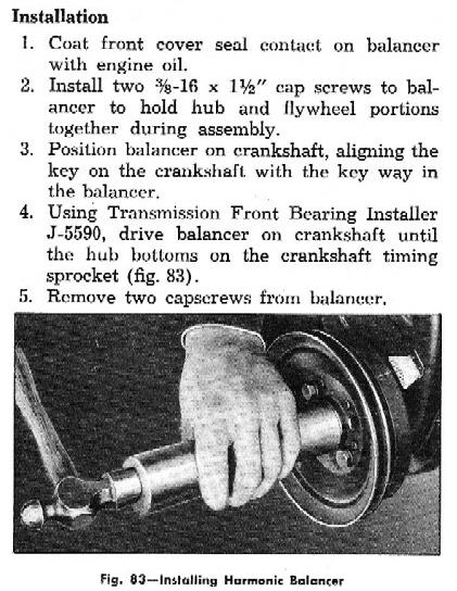

Chevy 6-s and V-8 used crank dampers located with a small key, but had to be driven onto the crank due to a cylindrical interferenc fit of about 0.0015".
http://www.crankshaftcoalition.com/wiki/images/3/3...
They graduated to included a lone centralized bolt (incapable of resisting shear forces) torqued to 60 or more lb-fts thus applying 1000s of pounds of axial clamping.
Other manufacturers used a slip fit, but usually with large crank bolts tightened over 100 lb-ft.
