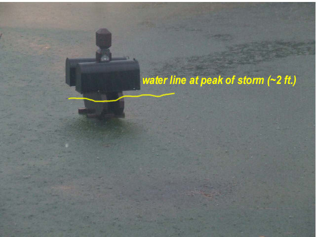

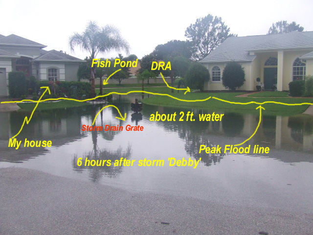

Hi guys...Firstly I am an EE so my knowledge of this kind of thing is limited.
I'll preface my question with this description of what we currently have in our community to manage storm overflow of a relatively large (approx 300'x150' by 8'?depth) ornamental fish pond.
When (severe) inclement weather occurs it appears, and I assume, that the pond's rising level is mitigated by a riser/overflow pipe connected to storm drain piping and subsequently to a smaller detention pond nearby.
The problem is that the smaller detention pond's also used for storm water (watershed) of the 'typical' surfaces, blacktop and green space and *I* believe that it is sized for the ordinary runoff rate. It always performs flawlessly until the ornamental pond overflows and then the detention pond is overwhelmed and floods private property at lower elevations by sourcing water(and fish) via the storm drain grates at street level, all of which are also connected to the aforementioned detention pond.
It appears to me, and again I'm an EE so I don't know much about this stuff, that this is 'flooding by design'. It appears to intentionally divert the larger pond overflow to lower elevations as a ‘circuit breaker’ without regard to flow rate.
My question(s) is this:
1) Is this the 'typical' hookup to mitigate overflow of an ornamental pond?
2) Am I correct in my assertion that all the methodologies used to size, volumetrically, the detention basin are 'thrown out the window' when making this extraneous riser/storm drain connection to the larger pond?
3) Any other ways that this might be implemented (I think pumps and controls) would be better to divert the overflow to a different detention pond a short distant away under controlled flow rate to share the burden.
I might of course follow up with a couple more questions later...
Oh, and thanks in advance!

There are many possible issues here. One distinct possibility is that if the one pond is truly "ornamental" and not regulatory in any way, it may have been designed without modeling how it affects anything. The overflow connection could be little more than an afterthought that wasn't sized to any specific criteria.
Before going to mechanical solutions, it would probably be a good idea to have the existing conditions modeled and seeing if non-mechanical changes (different sized pipes or structures) could be made in the system related to both ponds(this is typically much cheaper to construct and especially to maintain).
It would probably be a good idea to get the local agency responsible for stormwater involved to be sure one doesn't cause regulatory problems.

my first thought is that the detention basin is way too small. Flood control detention basins are generally required to be designed for 100-year storm runoff, not "ordinary" flows. If it is overflowing every 3 to 4 years, than it only has capacity for a very much smaller storm. (or you are having 100-year storms every 3 -4 years)
Regardless if the ornamental pond is part of the flood control system or not, the entire system should be designed to function adequately for a design storm which is much greater than 3- or 4-year rainfall.

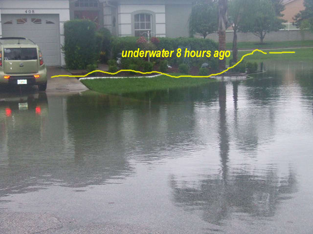

Well, this just gets worse....
The latest is that the HOA just repaired what they say was a shoreline erosion problem. I'll give them the benefit of the doubt but it seems to me that if it indeed eroded then all the material that comprised the shoreline before is still there within the confines of the pond.
Their contractor just added materials to the pond to produce a higher shoreline boundary, some sort of wrap and lots of stones. They removed no materials from the pond so the pond's effectively smaller in volumetric capacity.....the Community pond's designated, on the County Map (aerial photo), as a DRA in of itself.
But wait, it gets worse yet. I found in the minutes of the "grounds commitee" meeting a comment that states that a SWTMUDD ((Sothwest Water District) technician advised them to run the pond at a higher level to prevent future erosion.
The Community Pond is now in what I call a perpetual flood state as there's several inches of water in the DRA pond at all times now, regardless of rainfall.
So I'm not sure where to go with this from here. I'm going to visit the SWTMUDD to poke around and see if I can't recover the Hydrolgy study/model information but my neighbor and I don't have the wherewithal to hire a CE whereby the HOA has unfettered legal expenses and money (our HOA dues/money)....
Any advice? Perhaps I can post some photos (Aerial) and whatever else I can get my hands on so that I can (hopefully) not look too stupid when/if I need to take this in front of a judge to obtain an injunction.....
Thanks again.

Well, I don't know the elevation but it probably would be impossible to flood the first floor of our homes. I've had an elevation survey done for purposes of flood insurance and I recieved a LOMA (essentially a map ammendment to indicate the home is at a level above the flood plain) and the surveyor told me that there's no way, dues to elevations that I could ever flood.
We are generally concerned with sinkhole damage, foundation probelms, driveway/cars, and the never ending dead lawn (cost me $1200 to replace the last time) as sometimes it takes days for the water to recede...Oh, and the flood water blocks our entry/exit from the property.

Thanks for that posting as it gives me some much needed perspective. The flooding, at the street level, is near 20~24" as best I could measure it from ground level near my mailbox and close to the storm drain grate.
The lawn area is covered from this same flood water but absolutely is not due to grading because the water is sourced at that point from a street storm grating and travels uphill onto to my property (against a very steep grade).
My property slopes from my garage door to the street level (where the grate is) about 2 feet over approximately 25ft. It is rather steep. The adjacent lawn areas are covered in flood water all sourced from the grate.
It's difficult to visualize this but I'll try to clarify further. The DRA is near the back of my home. The larger fish pond is even further back behind my home on the other side of a main road. The storm drain pipes are under the road to the DRA.
The street in front of my home is the lowest elevation and the street storm drain inlet (outlet in this case) is at the curb level to the left side of the end of my driveway.......
Since water seeks its own level, the DRA assumes the level of the far away pond and begins to fill the DRA. At this time the storm connection that attaches this DRA to the my street storm drain grate sources water to the street (lowest elevation)....Phew, wish we could post pictures......
P.S. I'll post a picture to my Flickr account and hopefully you can see what I mean.
I'll post the link here.
RE: Community- Ornamental Pond, mitigating storm spillage/overflow
Ok, here some links to photos....Keep in mind that the storm peak was at around 8 P.M. and it was too dark to take photos so some of these were taken the morning after and one or two a couple days later...

"The flooding, at the street level, is near 20~24" as best I could measure it from ground level near my mailbox and close to the storm drain grate."
"The street in front of my home is the lowest elevation and the street storm drain inlet (outlet in this case) is at the curb level to the left side of the end of my driveway......."
Oh... I get it now. I should have read more closely up earlier in the thread..hammer
You are at the low point, or one of the low points, of your subdivision, yes?..Lucky you having all the fun!medal
Yes, that is too deep for the Minor storm event range at the gutter flowline in front of your home...Too deep for the Major event!! Reference my post above on flow depth criteria.
So this is a problem sourcing out of the public right-of-way, adversely impacting your property. This is a driver safety issue also. auto This is in the public realm of things now now.
So take your pictures, and pictures of your depth measurements wearing your waders if you have them, down to your City/County engineer and file your complaint.curse Tell them these ponding depths are grossly far beyond the street flow depth criteria and you want them to remedy immediately.flame
They may have sewer maintenance issues and/or other system problems. They will need to work backward from this problem location at the storm grate in front of your home.

If you look at the aerial photo you can see that the Fish pond's connected to the same DRA that my street, Mistwood Ct. is connected to. What's not apparent is that this same DRA services part of the Wexford Ave (main road) as well.
