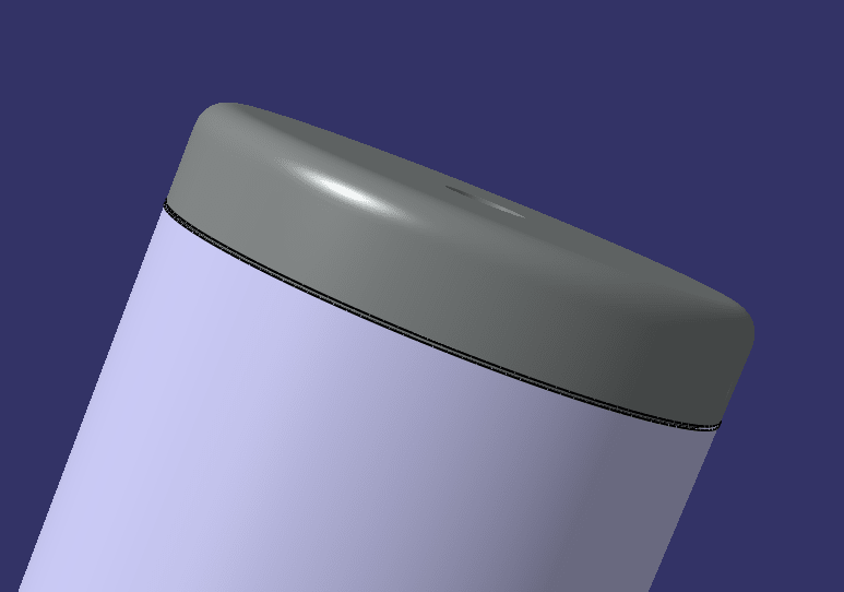

Hello,
I am looking for a way to attach a cap to the end of a tube and looking for some suggestions. The tube is Appx. 3" OD tube with .06" wall. The cap also has an OD of 3". Threading the cap on with internal threads into the tube is not an option. I'm looking for some more unique ways to attach the cap. Also, the cap cannot have any fasteners exposed. The cap should be removable so adhesives might be out as well. A simple twist-lock or maybe bayonet style connector would be neat, but looking for some off shelf components to make this happen. Maybe some type of push-lock connection?

any appreciable load applied ?
maybe a piece of spring steel, bent into a curve, ? to attach the cap you have to squeeze the spring to get it into the 3" tube ??
maybe two pieces shaped like an "S" (to balance the loads a little) ??
RE: Design - Need to attach a cap to end of metal tube
Along the same lines as rb, a lip with an o-ring groove on the cap, and/or groove in the tube i.d. Size the grooves so the ring "snaps" into both to hold the cap in place axially. If an o-ring doesn't give enough fixity, then a spiral retaining ring engaging a slight groove in the tube i.d. (caution, without a taper on the outboard wall of the groove, this can become a near permanent fit) - see the Smalley website for details.

It's a consumer product and it's a housing for electrical components. No extreme temperatures. 0F-100F. It shouldn't be too easy to open either. It would only open for major service and of course assembly. Tube is metal(steel or alum extrusion(I'm leaning towards extrusion as I can design internal features to hold components in place). The cap should be "splash proof" as well. I can fasten the cap into the tube from the inside with small screws, but it's not the most elegant solution, but seemingly most practical given design criteria.
here's a quick snap of what we're looking at:

Use a rubber plug sealing to pipe ID, with a grey metal outer shell.

How is your picture different from the Scooby Doo can - other than of course you don't have Scooby Doo on yours?
Mint, you're hilarious but always poignant and thought-provoking. Nice one.
The pic made me think of the key fob for clicking the car doors open and closed (and remote start, which is handy). The plastic clamshell is very well designed and I think it matches the OP's needs.
To change the battery is a challenging adventure with a thin-blade screwdriver or pocket knife, so it's not easy to open. There is no special cutout for an easy place to pry it open. It's gasketed against rain. I've had it apart and back together again at least four times, and it's still a booger to open.
There is also the interference fit on the back of my watch. Changing the battery in it is often accompanied by foul language and a craving for scotch and cheeseburgers. It's watertight to 100m. Also matches the OP's needs and is made of stainless steel.
Maybe you could look at how those are done?

Instead of a metal cap, I would use rubber stoppers which are used frequently in laboratories. That should simplify things and they provide splash proofing.
Better yet, glue rubber stoppers (somewhat truncated)into the inside of metal caps. You then have the best of two worlds
