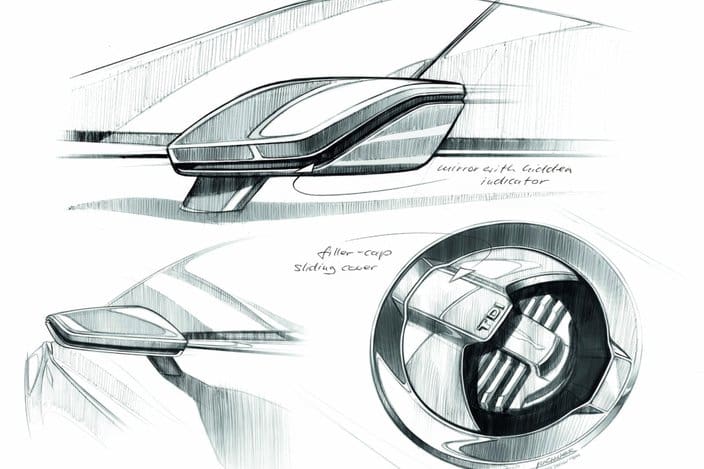

Hello
After creating a model..

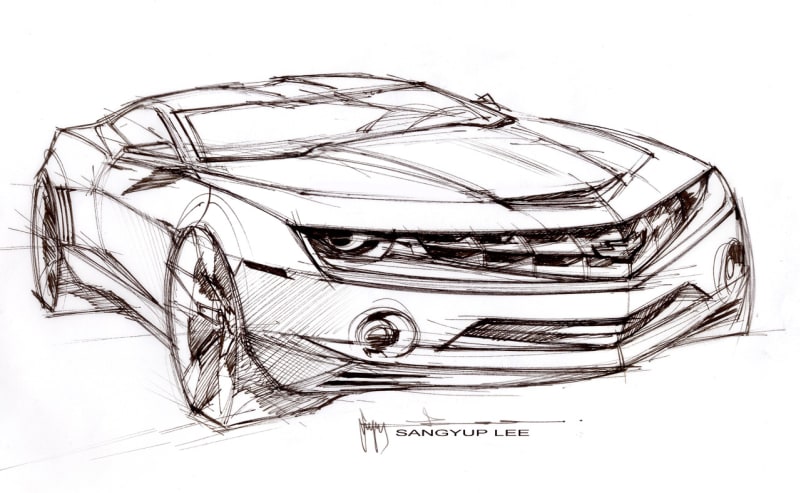

How can I get a pencil effect similar to these ones with NX or SW?
I don't know if I can achieve it with their default renderers or if I need some special render, such as Keyshot.
I don't know if I can get it while viewing the model in 3D or if it's just for 2D drawings or even if I need to postprocess the image with photoshop.
regards
