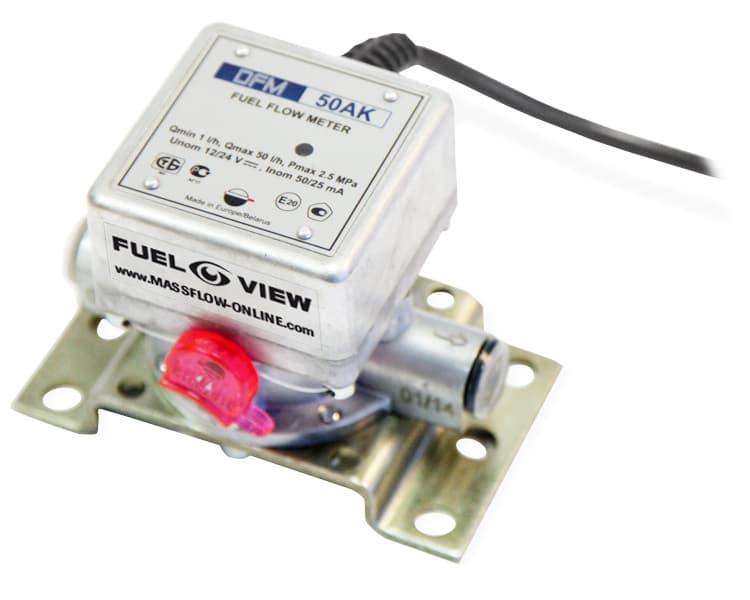

Meanwhile I have also had contact with several suppliers and received some interesting options:
http://www.massflow-online.com/cms/wp-content/uplo...
DFM-50A-K
http://www.massflow-online.com/shop/index.php?main...
Model: DFM-50A-K
Min: 1 l/h
Nom: 25 l/h
Max: 50 l/h
Engine: 80 (kW)
http://www.bronkhorst-cori-tech.com/files/br_corit...
Coriolis flowmeter: http://www.bronkhorst-cori-tech.com/files/br_corit...
Only, the problem for me is to determine what fuel flows will I reach and with which pressures I have to deal with (carburetor, 150cc 2-stroke engine).
I have done a calculation and based upon 1 hour of doing this test cycles the engine 'drives' virtually 22 km, with lines up with 1L of Petrol usage. So fuel flow is based upon this calculation 1L = 711 gr/hr
Can someone else confirm this? Or do they of other numbers? (just to make a comparisson)
But what pressures should I think of with a carburetor? When the fueltank is 5L = 3,5kg
The diameter of the fuelhose is 3~4mm (= 0.137 inch)
