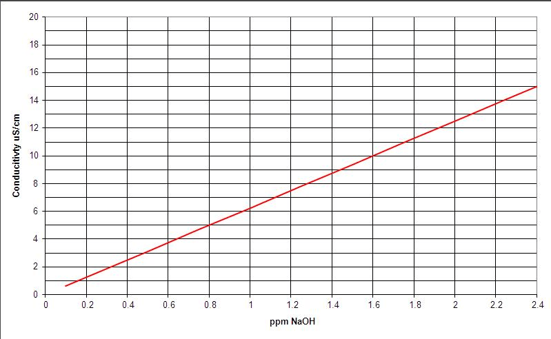

RE: Demineralised water - Effect on 304 Stainless Steel
Sorry, but it seems that you are adopting the reality to your theories.
First, it can be everything, starting from the traces of chlorides from cation exchanger, via the slip of carbon dioxide, silica, ammonia or sodium.
But OK, lets follow your assumption that it is 1ppm of sodium.
Therefore, from the commonly known table, assuming that there is absence of other impurities, you will have: pH=9.4, conductivity of 6.2uS/cm.
Sorry, but it is NOT ultrapure water for whatever reason you'd like to use it.
Lets go further, pH of 10, you said? so again, lets assume, as you want, that all of it is caused by sodium only.
Therefore, the amount of sodium would be 4ppm, with the conductivity of 24.8uS/cm (the conductivity, contrary to pH, is directly proportional to sodium ions concentration).
If you could not find the tables, although commonly available, here is a set of graphs:
dear bmir, let's start from... an end this time.
When you'll be on that stage of career in water treatment, you'll discover such units like CO2 degassers added before RO to decrease the load, as a standard in developed installations designed not for home users.
Sorry, but you're contrary to yourself. I can provide several installations [working, not existing in Lenntech (there are many other companies, did you know that?) web page only] which RO effluent is on or slightly below 5uS. This stage is frequently (for me, because for you it seems to be something new) used without polishing for example to fill and maintain the district heating circuits, where use of polished below 1uS water would be waste of chemicals.
By the way, part of the stream usually is polished, in the amount needed to feed the steam cycle.
Anyway, it is entertaining to see some professional stating that "you have removed just 50% of the ionic parameters in the cationic demineralizer unit.", as during whole of my education some people were trying to convince me that on cation exchanger only I'm just replacing metal and other cations (like ammonia) with the hydrogen one (or sodium, depending from the regeneration media: brine or acid), and ionic load remains same.
Finally, about the pH of 7: as you can see on the graph, it starts with NaOH content of 0.1ppm, which gives pH of 8.4. I'm sure that having some knowledge what the pH is, you can calculate what would be the concentration of OH- ions for pH of 7.5, right? Alternatively, you could use software like the Visual Minteq.
Last but not least: carbon dioxide is a common problem in pure water applications. and for me it is a surprise that you do not know it... I'll disclose you a secret: you can have perfectly pure water leaving your EDI or mixed bed, and same time you can face CO2 problem in application. This is the effect of installation of (another surprise for you) equipment called: demin water storage tank (do not mix up with feed water tank), and mysterious phenomenons called air ingress and CO2 dissolution in the pure water. It will even speed up in the presence of sodium ions causing equilibrium movement due to the formation of sodium carbonate and bicarbonate.
I think that you must be a lucky man, if you did not experienced such issues yet.
If you'd be interested, I can provide you with more details, but I propose private messages exchange rather than this thread.
