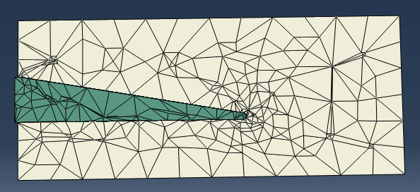

Hello. I am rather new to ABAQUS FEM and would be very grateful for some input on my model and study design.
My overall goal is to model how the tip of a needle interacts in human tissue. Specifically, I am interested in looking at the stress, strain and strain rate for small needle displacements inside of tissue. To model this interaction, I have created a 3D bevel-tipped needle and a block of tissue with the needle profile removed from the tissue, in Autodesk Inventor. I then import the CAD files into ABAQUS.
In my study, I have the needle inserted into the tissue and in contact with the tissue at the start of the simulation. I then want to add a displacement boundary condition in the 2nd step (after initial step) to displace the back of the needle 0.5 mm into tissue to observe the stress, strain, and strain rate.
However, I am having several issues:

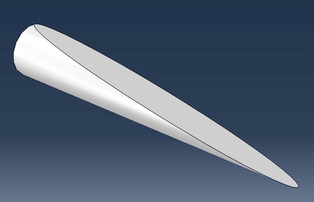

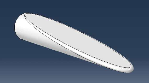

1. Mesh. As you can see in the images below, the needle has fillets around the beveled edges so that it does not "cut" the tissue. Creating a mesh for the needle (and for the negative profile of the needle in tissue), seems to be very difficult. I have tried partitioning the needle, but with no luck. Thus, I have reverted to automatic meshing with a bottom-up scheme and tet elements. I've read that this can be inaccurate for results, is this true? Needle image:
2. Contact. I can specify contact between the flat beveled face and the cylindrical shaft of the needle with their corresponding faces in the tissue block. However, I am having trouble specifying contact between the fillet of the needle edge and the fillets produced in the tissue edges. Since there is friction between the needle and tissue, I feel like I need to establish this contact. When I try to specify contact, I get some sort of error that the bevel face and the fillets overlap, and something about a "tie"? (Sorry, can't remember off the top of my head). Here is the initial state of contact between the needle and tissue:

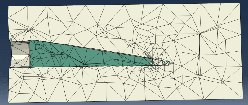

3. Insertion. When I displace the needle 0.5 mm into the tissue, I am finding that the needle actually moves straight through the tissue elements, as shown below! I am wondering why this is happening, is the tissue too soft (E: 7kPa) relative to the needle (E: 50 GPa)? I can't understand why the needle should go straight through the tissue elements.
Middle cut view of the needle in the tissue at the start of simulation:
Middle cut view of the needle in the tissue at the end of simulation with a 0.5mm displacement. Notice how the needle tip actually penetrates the tissue elements:
Thank you very much for your time!

1.
First order tet elements are not recommended for modeling contact. Have ABAQUS/CAE generate modified quadratic elements (C3D10M). On the other hand, use the Virtual Topology tool to ignore those bevels, partition the geometry, and mesh it with linear bricks.
2. I did not quite get the problem.
3. Contact interaction is not working. Have you ran a Hertzian contact problem from the manuals? If not, you must play with simple geometries first.
By the way, what kind of soft tissue are you trying to model? What is the Poisson's ratio of the soft tissue?

Like has been said, the Tet mesh isn't ideal. If you post your needle geometry you might get some better ideas for meshing.
RE: Modeling suggestions for my problem, please
He might just as well use linear tets, as all other errors and unknowns will be far greater than the 30% stress difference you might get from using linear tets. Other than that, I of course completely agree.
Since u are only displacing the needle, can't you just leave out the needle mesh, and put boundary conditions (or loads) at the 'hole' in the tissue?

Thanks everyone for your helpful insights.
So, since it seems that meshing the fillets is tricky, I decided to start with an easier problem. I'm just trying to insert a standard bevel-tipped needle into tissue. The dimensions of the bevel are 0.711mm diameter cylinder, 4.03mm long on the bottom edge, with a 10 degree bevel. The geometry is pictured below (again, no more rounded edges from fillets):
Now, without the rounded edges, I do believe I will run into a singularity at the needle tip (due to the very sharp point). However, even when I try to mesh this geometry, ABAQUS will only allow tets to be used. I've tried partitioning the geometry, but I am not sure how to do it properly.
Could someone give me an idea of how to mesh this geometry? It also seems there is some discussion about the accuracy of using tets for the mesh. Could someone give a quick explanation as to why this is the case? And why Tets are not ideal for contact? With my geometry, it almost seems I am limited to using tets, especially when I plan to round the edges of the needle.
Well, unless you are going to use plastics or other soft material, the metal is about 10000 times as stiff as the brain tissue, u clear cut case where using rigid bodies to represent your metal is perfectly justifiable. Even the softest possible metal will still be at least 1000x as stiff.
If you want to continue with the meshed geometry, mesh with tets but select the C3D10M element as IceBreakerSour suggests.
Are you doing the simulation in Standard? What contact are you using?
Try using the general contact (this will be the easiest) and let ABQ chose contact surfaces and edges.
If that fails, select the contact faces and EDGES yourself, and do an edge to edge contact to avoid the penetration.
I agree with sdebock. Unless you are interested in computing strains/stresses in the needle (which would be odd, to say the least), there is no need to mesh it.
In any case, no matter what you do, make sure the needle is the master surface. Also, have the soft tissue mesh to be *much* finer (than the needle mesh). Do not forget to verify the mesh quality is high. By the way, C3D10M elements converge slowly and one needs a fine mesh to get accurate results. You may also need to create a thin layer of membrane elements on the soft tissue and assign comparable stiffness to them, if you really need accurate contact stresses.
By the way, are you trying to model how the "cut" in the tissue progresses as the needle is pushed deeper? Technically speaking, are you trying to model crack propagation?
