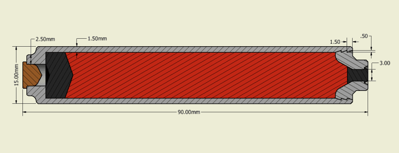

I am looking forward to develop a 15x90mm selfdefense cartridge, here's my drawing of how I see it.
This cartridge will contain.
1. a blank .22 round in the back
2. cartridge body ( shown in grey )
3. a cap ( also shown in grey ), that covers the front end and has a nozzle
3. a plunger ( black )
4. OC - pepper spray - solution
5. and a plug ( black ) that plugs the nozzle in the cap
When the .22 round goes off, its supposed to push the plunger and propel the OC solution out of the nozzle.
What do you think about my design in general? What materials do you think should be used for body and cap, considering that the .22 round gives off 45 joules of energy. Polycarbonate?
Thanks! :)

1.5mm wall 90mm long is a marginal flow path for PC. It's also hopeless with most solvents/greases etc. I would look at a LCP for the body* (better still, steel!)
* Can not see how you're going to mould the serrations inside the end, nor how you are going to achieve a leak-proof seal.

Thanks, I'll look into LCP. Steel would be too costly for such a round. The serration is only about 0.5mm , I thought it would be possible to pop it off the mold, wouldn't it?

Nope. Not with those sharp corners at 90º to the line of draw. Nor in LCP. A thread would be ok but adds tool cost.

Yea, thread's a good idea. Besides it could be could be either heated or glued in place, to get a tight seal.

Easiest way would be to have an external thread on the body, and an internally threaded cap. You could then put a seal inside the cap.

A .22 primer does not give off anywhere near 45 J of energy. That level of energy is equivalent to a .22 short, which contains gunpowder even if it has no projectile per se (i.e. a blank cartridge).
