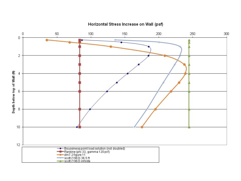

O.K. so now I'm a bit confused. . .
The attachment shows several hundred point loads spaced 1 ft on centers. The realm of the point loads extends 10 ft to either side of the wall measuring point and 36 ft back from the wall face. This is to typify an areal load of 250 psf. I used the Bousinnesq horizontal pressure equation. and contrasted those results to the horizontal stresses that would emerge from the Rankine theory. I did not double the Boussinesq results. It looks like I did in the upper 5 ft or so when you contrast the Boussinesq to the Rankine.
I have no idea what this study is telling me. . . I almost feel that the doubling effect makes more sense for a singular load, or a series of singular loads in proximity to and parallel to the wall face. I feel if the series of loads are perpendicular to the wall face the closer point load might-should be doubled but the ones back from the wall face have the closer loads acting as the "image" load, thus rendering the doubling effect irrelavent. Don't know. I just know what the results look like.

f-d: I attached a quick earth pressure comparison plot I did similar to yours and based on simple Rankine pressure plus a Bousinesseq and trial wedge surcharge added to the Rankine values. Hopefully I did not make any major mistakes in my haste. This is based on the Bousinesseq strip load formula with a 500 psf load at a 5' offset and a 15' load width. The Bousinesseq distribution is very sensitive to load offset and load width whereas the trial wedge distribution is primarily controlled by offset so long as the load width is wide enough to cover the trial wedge area.
The silly part about Bousinesseq and elastic theory is that one can vary the load width from 5 feet to 1000 feet and the answers and curve keeps changing albeit small after a point. Trial wedge has a similar problem with sloping backfills where the zone of influence can be nearly infinite at times. However, trial wedge analysis will have no surcharge influence on the wall at a depth approx. equal to the offset which is the principal difference I am after.
From my plot in this particular example, the total thrust may be in the same ballpark but the distribution is different. This may not be such a headache for cantilever walls but gets more interesting with soil nail and MSE walls where the pressure distribution becomes more important. Bousinesseq can not deal with backslopes so the theory is limited to simple analysis and not as flexible as trial wedge analysis. Part of my issue is also the concept of adding a Bousinesseq pressure to a Rankine or Coulomb pressure which are based on two different theories.

I like your plot. The only issue I have is you are using Rankine earth pressures from the soil below the ground surface. This force triangle is present with zero areal, line or point loads. For areal surface loads, the change in horizontal stress is defined by a rectangle as shown in my plot. It's just q-surcharge*Ka and does not attenuate with depth.

We are on the same page. The Rankine surcharge in my plot begins at a depth of 6' due to the offset via trial wedge and is roughly 150-160 psf at 10'+. The uniform Rankine surcharge would be q*Ka = 500 psf x 0.333 or 167 psf per the equation. The trial wedge solution matches this value for a uniform surcharge with no offset but the load offset creates a situation where the loading approaches the maximum value with increasing depth but never reaches it.
It is easy to visualize as the uniform q loading is not applied over the entire failure wedge due to the offset so the lateral load can never be as much as the full surcharge loading condition per the simple q*Ka equation.
My concern is the shape of the curves and where the surcharge loadings are applied as they are quite different. I used an example where the two curves look reasonable but they can look completely different if I used a higher loading and smaller strip width such as footing load which would create a large pressure "bulb" near the top of wall which dissipates rapidly with depth under Bousinesseq whereas trial wedge would show no effect until a depth of 5'+ and dissipates slowly with depth for a strip load.
How can they both be correct with such differences? Elastic and wedge theory are both reasonable in concept but fight with each other in practice. I tend to favor wedge theory because I understand it better but a large surcharge adjacent to a wall may result in a pressure spike that may eventually dissipate with time and wall movement. Almost a short term/long term consideration of the loading in my mind.
I still can not reconcile the 2X factor on Bousinesseq formulas for ordinary loadings and retaining walls though. It is too much different than wedge theory and active earth pressure for most applications unless movement is restrained.

Scott (1963) gives a formula for strip loading as shown on page 230. I ran that equation and it worked out very similar to the chart takeoffs of DM-7.2.

So, using Scott's method and running the areal load from the wall face to some infinite distance away from the wall, you are correct, the horizontal wall load becomes rectangular at (about) the value of the areal load (in my case an areal load of 250 psf).
This doesn't make any sense! So, you have to figure that this is some mathematical matter. I mean if we return to the vertical stress "bulb" at some point there is a practical limitation on how much vertical load can be conveyed to the wall. If there is no truely measurable vertical stress change then there's no correlated vertical component.
