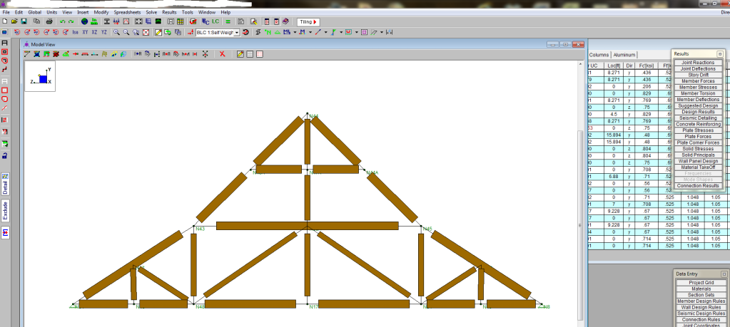

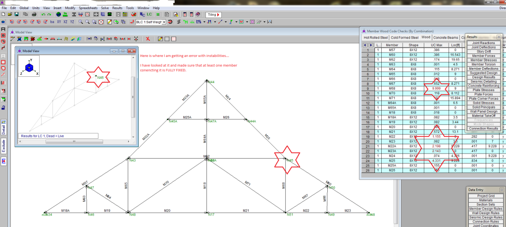

Good morning everyone,
I am just now becoming familiar with Risa.
I had watched the tutorials (which are very helpful), and ofcourse always keeping the "Risa Wood Design Training Manual" next to me.
I have been runnning into some issues when it comes down to getting results. But first of, allow me to let you know what I have done.
I have upload pictures of the truss on a photobucket.com
Here are the links
http://i1160.photobucket.com/albums/q490/parceromi...
Please take a look at it and let me know what you think.
Tank you so much for your help.

I took a few minutes to mess around with it. Check it out. I split the continuous members and changed some boundary conditions. The results are indicating what you would except from a truss. I had to change the species to SP to get the model to work as I didn't have the original grade in my database.

Thank you so much for your help.
I was able to contact RISA (RISA 3D) and worked with them.
We got it to work.
It was very simple.
I just needed to go into my tools menu and click on "Full Model Merge".
