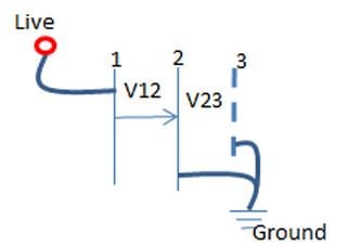

Considering E electric field intensity [as vector] constant across the insulation thickness
V12=E*d12 where V12=potential difference between conductor [1] and the grounded shield[2]
and d12 the insulation thickness.
E=V12/d12 [approx.] If V23=0 then E=0.
If the shield is grounded no electric field will be between the shield and any other grounded object[included armor] since the potential difference will be null.
