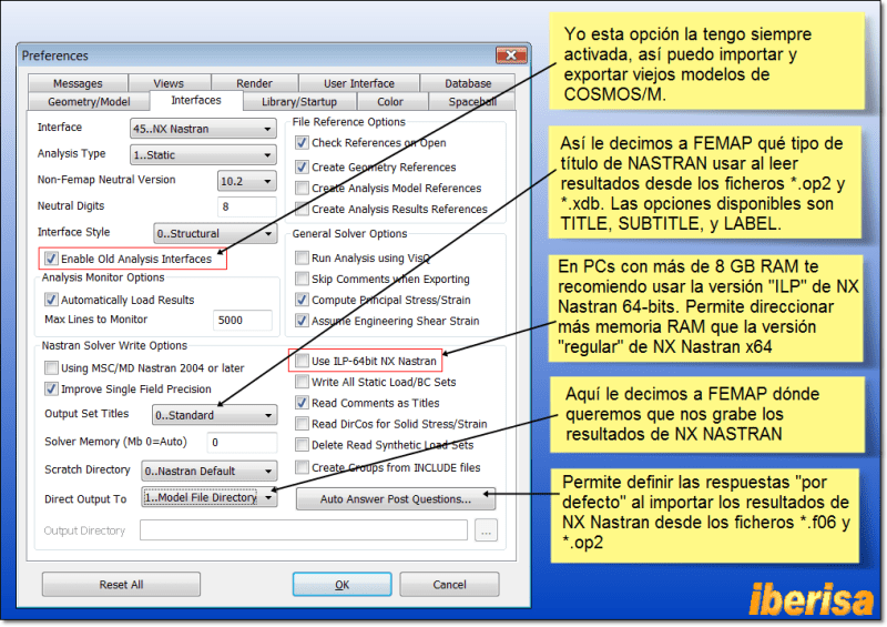

RE: How to convert a Femap Mesh in Ansys Mesh?
Hello!,
You need to go to "File > Preferences > Interfaces" and activate the option "Enable Old Analysis Interfaces":
Best regards,
Blas.
