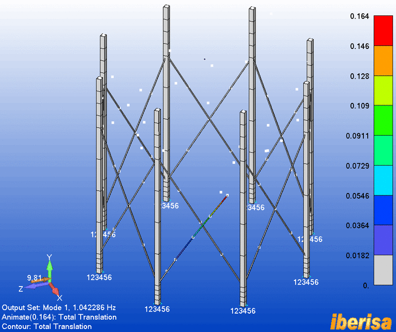

I have a question of a beginner. I think anyone could answer me. It is a model in Patran
I have a modelled the typical spherical tank of gas. It is a sphere surrounded by a circular beam along its perimeter.
Also the sphere is separated from the ground by eight vertical beams. These beams go from the ground to the circular beam. And there are also St Andrews bars between the vertical beams.
The vertical beams are fixed in translations and rotations to the ground.
The f06 files says: "USER ACTION: CONSTRAIN MECHANISMS WITH SPCI OR SUPORTI ENTRIES OR SPECIFY PARAM,BAILOUT,-1 TO CONTINUE THE RUN WITH MECHANISMS.
Which movements would you restrict for the Sphere and in which part of the sphere? I have modelled the whole sphere without symmetries
Many thanks all.

Dear Seabass8,
You have "rigid body" movements in your model then your stiffness matrix is singular, not anougth constraints defined or a joint failed, to debug the modeling error you can include in the NASTRAN bulk data section the card "PARAM,BAILOUT,-1", re-run the linear static SOL101 analysis and animate the displacement results, you will see where the error is located, OK?.

RE: Boundary Conditions for a sphere
Hello!,
A simply visual inspection rotating the model will show you that you have a member free at one end. Also you have many nodes free, with no connection with any element. And only CBAR elements exist, not any track of Shell elements for the spherical tank.
Hello again,
Thanks for your comments. It really helps me.
Here I have got a more accurate model. I´ve solved the problem of the free nodes and the brace
that was not well pinned.
The deformations look realistic. But looking at the .f06 some elements have a taper ratio greater than 0.5.
In my opinion the Boundary conditions are well established.
Hello!,
The QUAD mesh of the sphere is a litle disaster, you are violating the minimum quality checks imposed by nastran:
