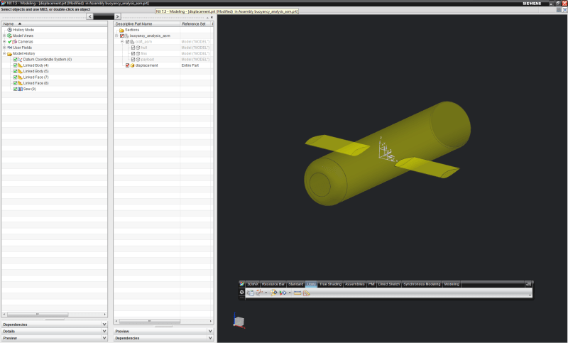

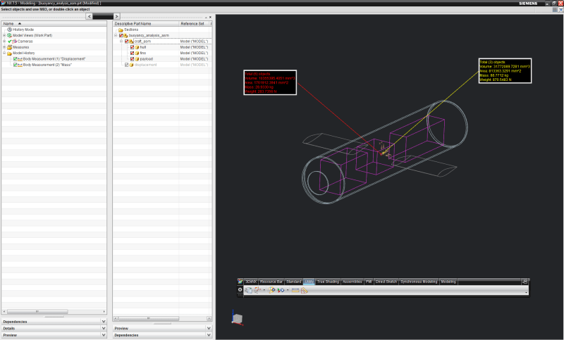

As John say the associative measure body command (analysis-> measure bodies ...) is the one you want, to find the center of buoancy i would do as follows
1 - Create a top assembly for the craft.
2 - Create a displacement component and link the displacement envelopes as solids or in the case of hollow components as faces.
3 - In the displacement component sew together any linked faces into solids, then assign water as the material property of all solids.
4 - In the top assembly create one associative body measurement feature for all the solids in the displacement component, and one for all the solids in the craft assembly.
an alternative method would be to create a displacement solid in each component and add it to a displacement reference set, that would remove the need for a displacement component.
