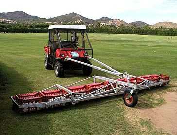

Passive RFID tags extract power from the interrogating signal. Therefore their range is relatively limited. So, upon detection, they're right there, within a few feet of the interrogator. I doubt anyone would bother trying to extract cm-accurate location from a passive RFID tag. It's theoretically possible, but impractical.
Active (battery powered) RFID tags (being a transceiver) could be location tracked over arbitrary distances using the obvious time-of-flight and phase tracking techniques. This sort of semi-obvious technology does not yet appear to have been commercialized. Many academic articles, very few actual systems.
In any case, it's a solved problem in the most-likely application:
