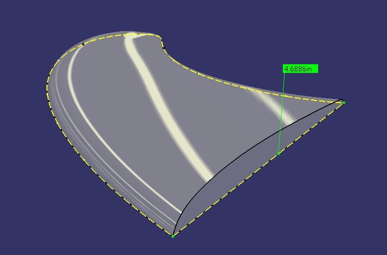

Hey Gurus,
I'm doing a production run of some glass-filled PP parts. I'm getting a knife edge at the parting line that needs to be polished down to a small chamfer/fillet. Due to the geometry,schedule, and cost, we cannot change the mold.
Is there any special abrasives that will not leave any residue on the parts, machinery, or tools that will quickly and consistently polish the knife edge? Costs need to be low and quantity is less than 10k pieces.
Currently, the most effective way is with a sanding block and person doing each part by hand. There are inconsistencies and time involved. I was thinking about maybe a special heated tool that will melt the edge of the parts that will quickly melt down the knife edge.
Any ideas are appreciated.
Thanks In Advance.

Thanks, but it's more than just flash. The actual flash is very minimal and can actually be removed with a finger nail. The molding facility wanted to avoid knives if possible. The part itself has a sharp edge around it's perimeter which coincides with the parting line. It's the part geometry.

You say the part itself has a sharp edge that is part of the geometry, yet you want to remove it? Do you need to de-flash and maintain a degree of sharpness, or is the sharpness due to excessive parting line erosion?
If you are material safe on the tool and have the tolerance on the part, the parting line faces can be re-ground to help eliminate flash.
A picture or drawing would help greatly.

It's easier to show with a shot from the 3D model. I've highlighted the edge that needs to have the edge rounded over slightly. There is minimal, if any, flash on the parts coming from the mold.
I understand that we could have put a radii on the part and then shift the parting line up. Likely, down the road we will make this change.(When time/money permits)
We're going to try the safety knife and will report back, but still open to trying other things.
Thanks.

It kinda looks like a surf board fin.
To mould the dad on the leading edge you need to cut a cavity in the other half as well. I agree that substantially increases the cost of tooling.
The safety knife is the way to go if the rad or chamfer can be small and precision is not required.
