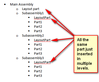

Each part within my assembly will need to reference some or all of these dimensions. I thought that it would make sense to start with a top level sketch of lines, dimension the space between them, then label and link those dimensions to a design table. I expected I would then be able to call upon those dimensions when drawing sketched within future parts w/in the assembly. But I seem to be unable to reference those root-level dimensions from parts I create. Am I missing something?
RE: Global Variables within Assembly / Parts
Nope, you hit the nail right on the head.
The benefit of using a "layout part" vs just using the layout sketch in an assembly is the performance gain and ability to change your file structure very easily.
If you're on the Solidworks forums take a look at this: https://forum.solidworks.com/message/130098
Also anything posted on there by Mauricio Martinez-Saez, the guy is a top-down master.
To recap, you want to insert a "layout part" and make sure and tie your references back to that part.
Tony Greising-Murschel, CSWP
Hi Tony. Thanks for taking the time.
I have come across Mauricio's post numerous times when searching around on this. I've downloaded that model - and an updated one he made as well. And his pallet assembly/configurator. I still must be missing something.
I have created an assembly like that, trying to mimic the layout in his tank assembly.
The steps I took:
1)Create part with a single sketch consisting of lines. Space between lines is dimensioned, named, and linked to DT.xlsx - let's call this part "RefGeo"
2)Create assembly. Insert RefGeo part.
3)Create subassembly. Insert RefGeo here, too.
4)Create new part w/in subassembly. Draw and attempt to call upon dimensions in sketch from RefGeo.
5)Fail ponder. The wonderful thing about using the txt. files/global variables is that when I go to dimension a line, I simply type '=first few letters' and it finds the variable I'm looking for. That clearly doesn't work in this case, so I've tried exiting the sketch, double clicking on the dimension, then trying to "activate" the RefGeo sketch to do an =*click* on the appropriate dimension, but that doesn't seem to work.
What this could tell me is that his system relies on in-context references to the root sketch -- coincident points, co-linear lines, co-radial circles, etc. But I've read Mauricio and others mention sketches like I describe - arbitrary lines with named dimensions linked to a DT. But clearly I can't figure out how to reference them.

I figured it out. I was failing to see that I needed write out the reference completely.
Here's what works. An assembly level sketch called "RefSketch" with arbitrary lines and named dimensions linked to DT.
Create a new part, draw a rectangle - no in-context relations other than positioning. Add dimensions, extrude. Open up the equations dialog box and edit the values to look like this:
D1@Sketch2 = "Depth@RefSketch@assemblyname.SLDASM"
