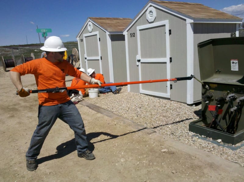

That said, you may be missing the subtle difference in those statements. "Distribution cutouts" are not the same as "fused cutouts" used in transformer vaults etc. They are the open style devices that are used on utility poles and switchyards by the utilities, operated from the ground by a lineman with a long fiberglass pole.
Distribution cutout:
Fused cutout in a transformer vault:
Still operated by a pole.

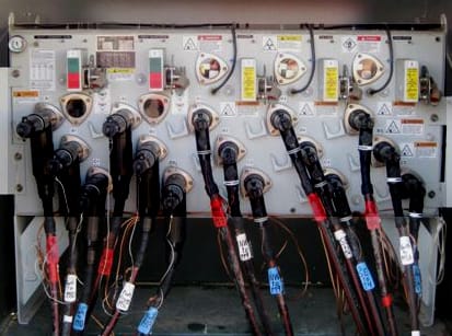

And sometimes people use the wrong terms for what is being implemented. If it is an enclosed switch with its own handle on the outside, it's more likely a Fused Load Interrupter Switch:
Or if you are not sure if there are fuses inside, a Vacuum Switch, an SF6 gas switchor even an Oil Switch, (although usually for 15kV class systems, they are sometimes used at lower voltages, especially underground).
