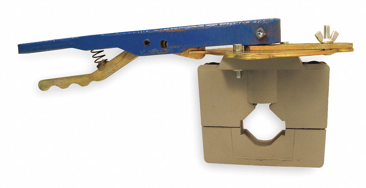

I have a current design that I wish to use a spring loaded lever that can be pulled out in order to obtain different locking positions with a set pin. I know I have seen these types of levers used in other systems but my research has come empty trying to find a company that fabricates these. Are there any companies that do make spring loaded levers or is it something I will have to design from scratch?

RE: Spring loaded level/handle
Like this?
Eh. Kind of like that. Instead of the clutch on the bottom of the lever, it would just be a matter of pulling the handle out axially wrt the shaft to adjust the position of the lever
Ergonomically/mechanically your proposal is likely to be tricky to get working satisfactorily. The Off axis torque on the sliding joint as the operator attempts to pull the handle along it will tend to casue it to bind. I have seen what you propose, but they use a knob not a handle, so there is no off axis torque.
