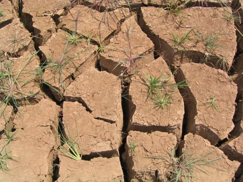

RE: Soil Dessication
This is my summertime desktop photo. It's from Panama and residuum from volcanic tuff. We used this stuff for earthwork (maximum dry density was less than 80 pcf).
Varved clays are more likley to have the 10 fold distinction between horizontal and vertical permeability.
Yeah, I'm in Virginia, but I've worked all over the country, except for Texas 'cause it's too hot!!!!!!
