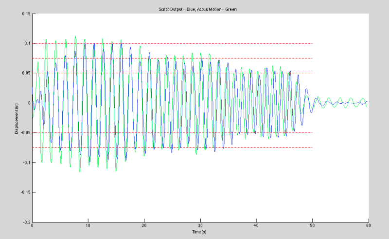

I am using fast fourier transforms to convert raw acceleration to displacement. I am able to get extremely close to expected results; however, I am having issues at the beginning of the dataset. I believe there may be an issue with the filter I am using.
Here is the code for the butterworth filter I am using
CODE --> Matlab
[B,A] = butter(5,0.5/(Fs/2),'high');
I apply it to the raw data and after conversion.
Here are the results, I move the device +/- 10cm, +/- 7.5cm, and +/- 5cm as seen. The green line represents actual movement and the blue line represents the dataset produced through the conversion algorithm.
Any suggestions for better filtering techniques? I can provide the code and some data upon request.

the green line is the correct representation of the motion

this is not for school, the green line is a completely different instrument...
advice is welcome...

Use a FIR filter, Matlab fir2 maybe, since IIR has nonlinear group delay you will see different time shifts for different frequencies. You can then 'shift' the resulting filtered data by just defining the x-label for plotting purposes or by filtering using filtfilt.
