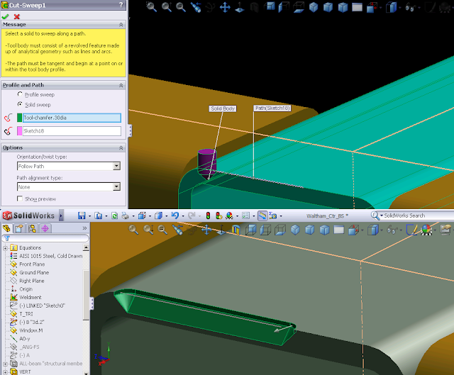

On a plane perpendicular to what jboggs suggested at the depth of the chamfer, sketch a slot that is the root diameter of a 45 degree cutter and then cut extrude and apply an outward draft at 45 deg. You could also do a Swept Cut Solid. Create a solid revolve of your milling cutter, whether a straight mill or 45 chamfer mill, click off the "Merge" radio button when you revolve. then sketch the path to follow, then use the sweep cut command, at the top of that pick "Solid sweep". I have attached a part showing 3 of the ways I think work pretty well.

mncad - I like the extruded slot method. I have to say, the third one though, using a solid and removing material... Would never have thought of that! I'll keep that in reserve for future use!

SolidWorks has a sweep solid body option that can be used to sweep a separate Solid Body that is used as the cutter. You can use a partial length curve like you mentioned with the Convert Entities command or split the faces to make a smaller edge.

Here's the image showing the Solid Sweep option I posted yesterday. I did not have time to post it yesterday in my original message.
