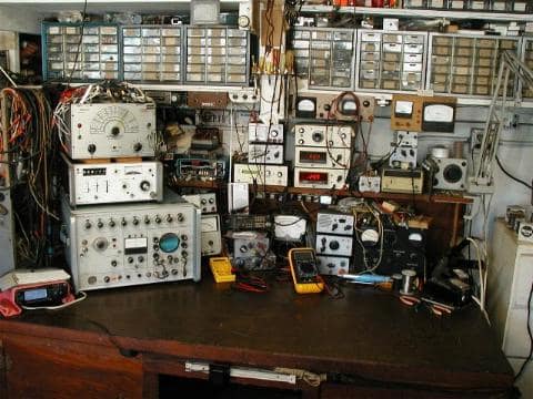

They are describing something like this:
Here's a rather neater bench:
RE: EE testing lab - configuration suggestions
Note that in both cases, you can actually see the underlying bench, so no actual testing is going on. winky smile
Seriously, the one devolves into the other, as test sequences evolve, and you are forced to rearrange the test instruments so that all the necessary test leads will reach the UUT while remaining short and direct enough to not degrade the test data.

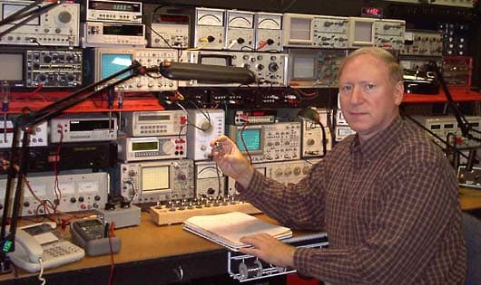

The late Jim Williams' work bench.
Hahaha! I actually went looking for that bench and only found those other two. Kudos VE1BLL.
Keith Cress
As famous as Bob Pease's desk...
