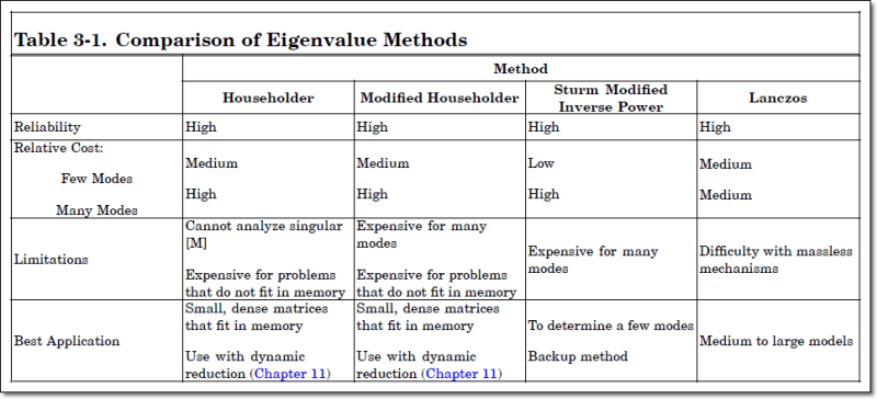

Eigenvalue Extraction Methods (I will explain the options I know using NX NASTRAN FEA solver)
Seven methods of real eigenvalue extraction are provided in NX Nastran. These methods are numerical approaches to solving for natural frequencies and modes shapes. The reason for seven different numerical techniques is because no one method is the best for all problems. While most of the methods can be applied to all problems, the choice is often based on the efficiency of the solution process.
The methods of eigenvalue extraction belong to one or both of the following two groups:
• Transformation methods
• Tracking methods
In the transformation method, the eigenvalue equation is first transformed into a special form from which eigenvalues may easily be extracted. In the tracking method, the eigenvalues are extracted one at a time using an iterative procedure. The recommended real eigenvalue extraction method in NX Nastran is the Lanczos method. The Lanczos method combines the best characteristics of both the tracking and transformation methods. For most models the Lanczos method is the best method to use.
Two of the real eigenvalue extraction methods available in NX Nastran are transformation methods:
• Householder method
• Modified Householder method
The real eigenvalue extraction method available in NX Nastran is classified as tracking methods:
• Sturm modified inverse power method
COMPARISON OF METHODS
Since NX Nastran provides a variety of real eigensolution methods, you must decide which is best for your application. The best method for a particular model depends on four factors: the size of the model (the total number of degrees-of-freedom as well as the number of dynamic degrees-of-freedom), the number of eigenvalues desired, the available real memory of your computer, and the conditioning of the mass matrix (whether there are massless degrees-of-freedom). In general, the Lanczos method is the most reliable and efficient, and is the recommended choice.
• For small, dense models whose matrices fit into memory, we recommend using the automatic method (automatic Householder ). The automatic Householder runs modified methods if the mass matrix is singular; however, it runs the unmodified methods, which isfaster, if the mass matrix is not singular. The automatic Householder method runs faster on computers with vector processing and also supports parallel processing computers. Note that most real world problems are not small and dense, unless you use reductive methods such as superelements.
• The Sturm modified inverse power method can be the best choice when the model is too large to fit into memory, only a few modes are needed, and a reasonable eigenvalue search range is specified. This method is also a backup method for the other methods and is used when a check of the other methods' results is needed.
• For medium to large models the Lanczos method is the recommended method. In addition to its reliability and efficiency, the Lanczos method supports sparse matrix methods that substantially increase its speed and reduce disk space requirements.
