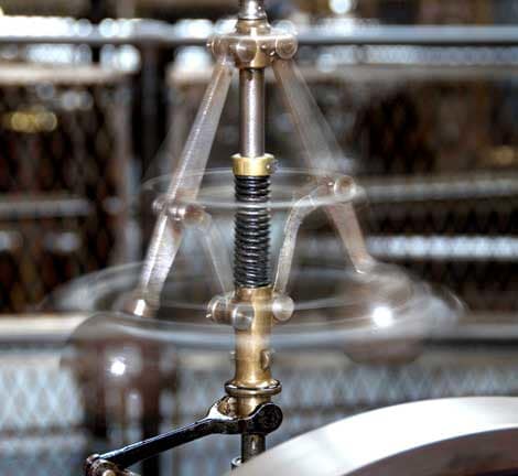

How about a centrifugal governor that is only engaged on the upward stroke of motion?
Adriaan.
