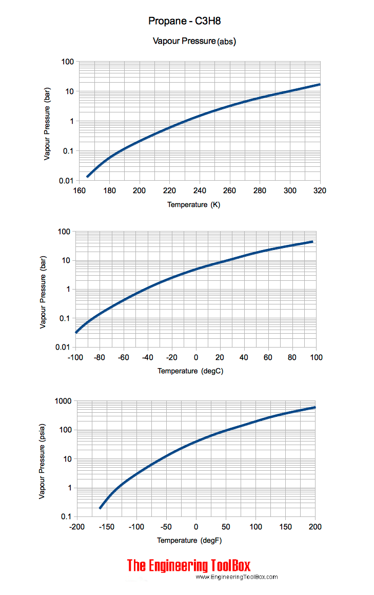

The vapor pressure stated for propane at 100°F is comparable to a value from the graph here:
http://www.engineeringtoolbox.com/propane-vapor-pressure-d_1020.html
I trust the lab's number.
I don't trust the operating pressure of 140 psi at 100°F for a closed tank of pure propane.
RE: Pump NPSHA
Propane at 100 F on that chart shows to be 180 psia - 14.5 = 165.5 psig
