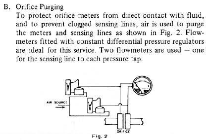

It sounds like the tar deposition was a problem for the DP cell, not the pitot tube.  An approach for keeping the deposits away from the DP cell is to purge the impulse lines.
I've never actually done impulse line purging, but it is not unknown, and has been addressed in instrumention publications in the past.
The lower diagram shows impulse purging lines for a slurry line, obviously with liquid, so the taps and associated purge components are low on the main line.  For gas, you'd want to 'flip' it so the taps and stuff are on the upper half of the main line.

What's intriguing is you've already got the flow element installed, a DP cell, all you need is to get what you've already got working consistently enough to detect reverse flow while keeping the DP cell from clogging
