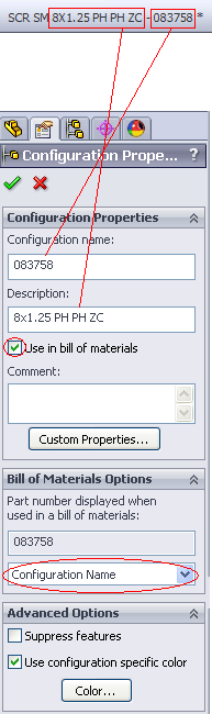

I am trying to create a macro for solidworks that will pull some information out of the file name and put it in the configuration properties.
So far I can parse the name fine as well as change some of the fields within the properties, but a few of them are giving me some trouble.  Mostly the "description" field but the checkbox below that and the BOM options are inconsistent at best.  The Part.EditConfiguration3 command doesn't play nice with the description field.
If someone would point me in the right direction, I've attached a picture showing what properties need to be filled in and checked.  Thanks.

RE: Need help with a macro to fill out configuration properties
Here is my crude macro, it gets the job done:

You probably will need to edit the way it gets the part number and description for your own use.
