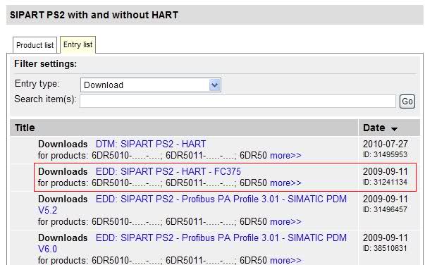

How do I communicate with this thing with my hart 475 communicator? Please help!
RE: Siemens ps2?
Like you do with any transmitter, assuming it is HART, but do not power the PS2 with a 24Vdc power supply, power it with 4-20mA loop simulator.
Install the PS2 HART DD in the handheld.
If Rosemount doesn't have it, the PS2 positioner's DD file for the 375 is here:
http://support.automation.siemens.com/WW/llisapi.dll?func=cslib.csinfo&lang=en&siteid=cseus&aktprim=0&extranet=standard&viewreg=WW&objid=42086580&treeLang=en
Note that the outlined download is for the 375.
Power the positioner with a 4-20mA loop power simulator, NOT a 24Vdc power supply.
The PS2 has more than 250 ohms inptu resistance so the handheld will read it by attaching the leads on the PS2's analog input.
