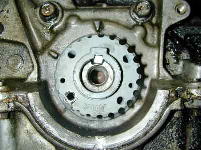

If the load is strongly one directional, either from gravity or a drive belt, etc, the tendency for the outer race to "spin" (creep, really) is pretty small. Bearing fits spedified in bearing catalogs reflect this.
If the load direction continually varies in direction a pin won't prevent the micromotion. That's why keyed shafts by themselves don't last long.
 http://www.miata.net/garage/hsue/Loctite%20Crank%20Fix%20-%20Part%201_files/crank5.jpg
