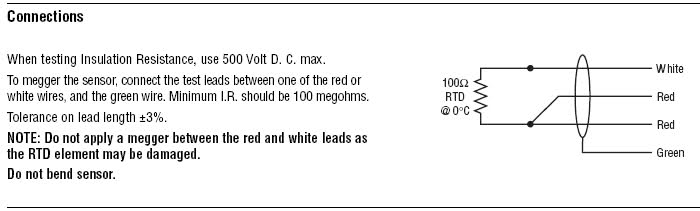

I can't answer whether the test is necessary or not (the couple motor installation manuals I've run across do not mention megger testing RTD's), but Tyco Thermal provides details of a megger test for its RTD's used for heat tracing.
See page 3 of the Tyco manual is here:
http://www.tycothermal.com/assets/NorthAmerica/English/Documents/Installation_Operation_and_Maintenance_Manuals/Products/487/H57328_RTD10_20_II_0103.pdf
Be warned that RTD wire colors are not standardized, red/red/white is common but not universal.
