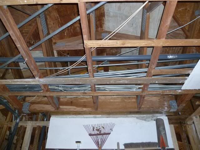

I need some advice on a truss repair at my resident.
Some background. The area of repair had a roof leak, and previous owner let it sit and rot. I discovered the problem when I had to rework some electrical conduits in the attic, so I removed some ceiling sheetrock and found that the heel of one truss has completely disintegrated - meaning I can break pieces of the wood off with my bare hand. Here is a simple illustration. The dashed line section were rotted away.
The good news is, it appears to have been in this condition since 2004, and the roof has not sagged.
I took a recipricating saw and cut back to where I have solid wood, then I supported the joist with a double 2x4.
My first thought was to put in new 2x4s to replace the missing sections, then use plywood gussets on both sides. However, with both the rafter and joist missing a short piece, this may not be good enough. I decided to sandwich the original rafter and joist on both sides with new 2x4s.
First, I nailed a sheet metal plate from the back side to the original joist. Then I put a 10 feet piece of 2x4 behind it. Nailing the other half of the metal plate to the new 2x4. Then I did the same to the rafter and attached a new 2x4 behind it. I nailed the old and new wood together with 3" 10d nails spaced every 10" or so. This is depicted below. The original 2x4 is of darker color, the piece behind it is the new sister 2x4.
A closer view.
Next, instead of putting in new 2x4s to connect to the original wood members, I cut two sheets of 3/4" marine grade plywood to the shape as shown below.
The two sheets of 3/4" plywood results in the same thickness as a 2x, and is more rigid because it's made out of one piece. I plan to glue the plywood to the new 2x4 behind it, then nail it together with 3" 10d nails, as shown below.
Then I plan to put in another 2x4 joist and rafter to the front of it, nail them in place, then drill 3/8" holes through all three wood members every 24", and use 3/8" bolts with large washers and nuts tightened from both ends. The plywood sections would be in the middle when I am all done.
Would appreciate any comments on the approach and what I could do better. I think this gives it the best support. Thanks in advance.

On your side, the truss has remained standing for some time with this condition.

I am a licensed engineer but my area of specialty is on drainage and roadway design, structures is not my thing and I vaguely remember my moments and shear calculations during my college days.
I guess my point is, with this particular truss, and I think the pictures showed the amount of conduits and pipes that pass between the joists and rafters I am limited with what is possible.
There is nothing supporting this truss in mid span or anywhere in between. However, the next truss over (as can be seen in the first picture) is a double truss, two 2x4 together, then another 2x4 truss 24" over,followed by another one, then another double 2x4 in that pattern. I think this is why the rotted truss has not cause a sag, the double truss next to it has absorbed the load.

A measure of this force could be determined from the connection plate just inboard from the point of support.
CCMC has tabluated values for plates based on shear, tension, and grip. In addition for there being values for parallel and perpendicular to the grain for the lumber, there are also values based on the orientation of the 'teeth'.
Your plywood gusset idea is pretty sound, going back to 'real wood', not rotted... check with a nail, screwdriver, awl, or pocketknife to determine the extent of damaged wood, and carry your gusset well beyond that.
I'd secure the gusset with Bulldog PL adhesive... not nails or screws..

Miamicuse.... I would like to know more about why every other existing truss is doubled, so your're not missing something. I would prop that truss up to take most of the load off the bearing end while you are making this fix, and as Woodman suggested the primary props should be at bot. chord panel points, similar to the double 2x4 post you show. But, your prop just tends to bend the bot. chord. Note that what you call a rafter, I call a top chord; and what you call a clg. jst. I call a bot. chord of the truss. You must design a steel nailer pl. connection btwn. your new top chords, and your new bot. chords, across the horiz. cut on the top chord to the bot. chord. The truss forces, from a truss analysis, will dictate the forces at that connection. And, what Dik was explaining applies to the design of these nailer plates. And you must tie your new chord members into the old to transfer the truss forces in those members. I would use glue, clamps, and lots of nails, and forget the nuts and bolts. You must pay attention to edge distances, end distances and nail spacing, both lengthwise and across the grain. In this case, many smaller connectors from both sides, 16d or better yet 20d nails will work better than bolts would.

On jacking up the truss to transfer the load. This has already been done. After I cut the rotted wood sections out, even though there is no sag in the roof deck and nearly framing - and I checked with a level and strings. I know with the heel completely gone I need to put it back in it's original configuration and angle. I used a bottle jack and a 4x4 beam to move up the bottom chord by about 1/4" from level. I then hammer in place the double 2x4 temp support that you see now and removed the bottle jack. This support is going to be removed once I am done. I also jacked up the top chord a little from where I had that temp support. I then attached the two 8' 2x4s to the truncated top and bottom chords.
Regarding the metal plate, it was there initially to attach the bottom chord to the new sister 2x4. I realize it is not going to work, it's just a temp mending piece.
About the rot treatment. I cut back the bottom chord to where I had solid wood 100%. The top chord I didn't cut all the way back, I undershot it by about 1.5" because there is a member crossing above it and at the time I felt I needed that there. I did brush on Abatron Liquid Wood into the rotted portion and filled in some Wood Epoxy. It is only the last 2" that is still partially rotted up top.
Woodman88 mentioned that the way I had the 2x4 sistering the top/bottom chord is wrong, let me make sure I understand fully. I think you are saying that I should be doing illustration "A" and not "B", right?
I think it is extremely difficult to take this out now because I have nailed the members together at close intervals, I believe if I try to remove it now, all the prying and pulling will result in more weakening of the original chords. However, may be I can find a way to connect them that will help? Can I drill a vertical hole from the new sister top chord, through the bottom chord, through the top plate of the bearing wall, and use bolts to secure them tightly, or insert another piece between this top chord and the bottom of the roof deck to wedge it in? Also, since I have not yet put in the front 2x4 to sister it, I could certainly cut the front members the right way.
As far as using the right terminology, my apologies. I tried to go back and see if I can edit it, but not any more, I will use the proper terms from now forward.
My first instinct upon seeing this situation, is to use large triangular gusset pieces to mend the chords at the heels and extend that as far up the truss as possible. However, as you can see with all the electrical conduits, this is just not possible. That lead to the "contraption" approach I have now.
To dhengr, about your question on the double truss, let me elaborate. It is not every other one, what I wrote initially may have been confusing. What it is as you go further to the right, I have a fire place. All the trusses heading to the fire place (three of them), instead of attaching to the mason wall of the fire place, they attach directly to a double set of 2x10s. This double 2x10s "hangs" on to double trusses on both ends, as shown below.
and yes, the gusset plywood pieces I have is a filler piece between the new 2x4 members sandwiching the original top and bottom chords.

If so how do you attach the nails? I was using an air palm nailer. I plan to use both nails and adhesive as dik suggested above. However, I can only attach where the 2x4 footprint overlaps with the plywood, which is limited.
I wonder, once the triple ply 2x4 are all said and done, would it help strengthen the rigidity of the heel joint if I add two more layers of ply outside of the sistered wood further up from where the pipes are. I am not sure it would.
Another idea I have been thinking, is some sort of custom fabricated sheet metal that wraps the whole three ply heel in one piece on the outside of what I have.

I saw this article about marine grade epoxy by West System. In this article they talked about embedding a rebar inside a wood beam secured with epoxy.
http://www.westsystem.com/ss/beam-me-up-2/
I am wondering, instead of the two ply gusset that I had intended to put in the middle, would it create a better and more rigid joint if I do the following instead:
(1) cut the same shape out of a solid piece of 2x10.
(2) Drill a 1/2" hole 6" into the existing truncated top chord along it's length.
(3) Drill another 1/2" hole 6" into the existing truncated bottom chord along it's length.
(4) Drill two holes 6"deep into the edge of the 2x10 shape, in alignment with the holes in the existing chords.
(5) Epoxy into the holes two pieces of 1/2" rebar, then slide and hammer the rebars into the opposing holes in the existing chords (already filled with epoxy).
Will this mending with the metal rebar provided a more rigid and superior joint for my situation? Or this is a bad line of thinking?

Nevertheless, you need to make sure your repairs are consistent with the uplift and lateral load needs in your area.
I have designed repairs for exactly this condition for condominiums in Jacksonville and Orlando. I'll post a sketch...just don't have it on this computer.
RE: Residential Truss Repair Advice
For all the work you are looking at, along with trying to do the repair correctly, I would contact a truss manufacterer about having them field press (as it will need to be pressed inplace as you will not be able to insert it without removing the roof sheathing or pipes) a repair jack frame to nail to your truss. They can also give you a uplift and member forces for the connections.

You can use nails to secure the adhesive <G>... on many repairs, I have relied on the adhesive strength with a few nails to hold it in place...

This is a tricky project, so I am going very slow, I have other projects on going and this one I am taking baby steps and thinking it through as I don't want to rush it then regret later if there is a better approach.
I don't want to open the roof or relocate those pipes though...
Sometimes too much google can make things more confusing...LOL...

Take good measure and have a truss company fabricate a new heel with same measurements and go up about 4 feet or so on the top and bottom chord.
Then cut the existing top and bottom chords back. Install new 2x4 headers going from the previous truss to the next truss at the top and bottom chords. Then connect the broken top and bottom chords to the new headers, on both sides, using joist hangers.
Then ask the truss company for advice on how to reinforce the header connections to the adjacent trusses.
In my case, this is the last truss, so the "previous" would be a concrete wall, and the next is a double truss.
Any merit to this approach?

Feel free to complicate the repair as much as you like, but it is not really necessary for your own household use, for a roof which is not designed to take hurricane winds (which it appears yours is is not.)
It seems that the nearby gable end wall probably has taken the load since the damage occurred, if not before. The tributary width to this truss appears to be very narrow, resulting is low loading and low demand.
As pointed out, glue works well, but 1) you cannot assure development of the entire section through surface bonding only, and 2) adhesives are not recognized by the building codes for this application. So glue as you like (wood glue or a non-creep acrylic - 3M only makes one that is structurally rated and it is $$ per tube), but nail or bolt as well. Truth be told, it is nearly impossible to get full strength connections in reasonably-sized wood truss gussets without bolts, but that might not be necessary here.
Go back to your original design, which provided two 2x4 sisters for each rotted 2x6 member, and a tight-fitting filler (the plywood.) Bolt it all together, and call it a day.

What section of the IBC (or other building code) are you looking at that states it is not recognized for truss repairs?
Also, I have design repairs for a great many wood trusses and have always used nails/staples (sometime with the addition of glue) but never bolts or glue alone to connect plywood/OSB gussets to the wood members.
