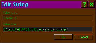

You don't need to make any changes to registry but if you double click the Registry Setting name
RecentFile# , it will show you the path to the File name already select and you can copy & paste that to File Open window.

Double Click one of the RecentFile# names
The Value Name/Data dialog will open and the files full path will already be selected. Double click will not work here so make sure you perform the copy before clicking in Value Data box.

Value Name: RecentFile0
Value Data:    C:\cad\_ProE\PROE_WF2\_et_kemangan-s_part.prt
