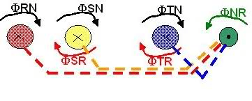

In my above post I missed: the zero sequence currents are equal [IR=IS=IT=Io] in each phase except neutral where is 3*Io. Then the magnetic flux will be spread other way.
Since the currents are equals and in the same direction the magnetic flux between phase R and S,S and T,T and R will be null and have to be extracted from the R to N, S to N and T to N.
FiRo=FiRN-FiSR-FiTR+FiSN+FiTN+FiNR
FiSo=FiSN+FiTN+FiRN-FiRS-FiTS+FiNS
FiTo=FiTN+FiSN+FiRN-FiRT-FiST+FiNT
FiRo=Io*(LRN+LSN+LTN-LSR-LTR+3*LNR)
FiSo=Io*(LRN+LSN+LTN-LRS-LTS+3*LNS)
FiTo=Io*(LRN+LSN+LTN-LTR-LTS+3*LNT)
LRo=FiRo/Io
As typical LRN=2/10^4*LN(DRN/reR) LNR=2/10^4*LN(DRN/reN) and so on then:
LRo=2/10^4*LN((DRN*DSN*DTN*DNR^3)/(reR*reN^3*DSR*DTR))
LSo=2/10^4*LN(DRN*DSN*DTN*DNS^3/(reR*reN^3*DRS*DTS)
LTo=2/10^4*LN(DRN*DSN*DTN*DNT^3/(reR*reN^3*DTR*DTS))
In your case:
DRN= 71 mm DSN= 46 mm DTN= 23 mm DNR= 71 mm DNS= 46 mm
DNT= 23 mm DSR= 25 mm DTR= 50 mm DTS= 25 mm reR=7.7 reN=4.8
LRo=0.002027 H/km LSo=0.001906  LTo=0.001351
The average will be :Loav=(LRo+LSo+LTo)/3=0.001761 H/m and Xo=4*pi()*50*0.001761=1.1064 ohm/km.
