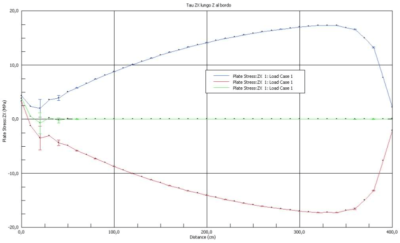

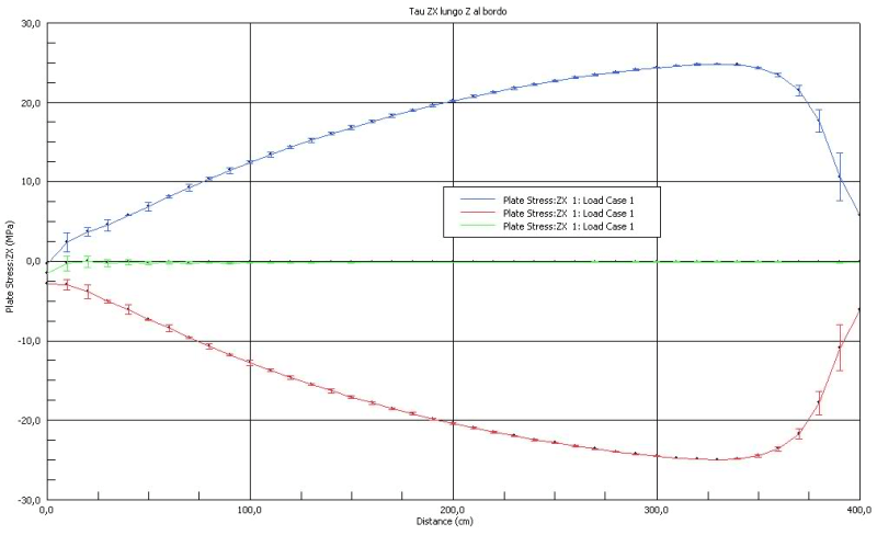

I took the now famous double-T section, and I modeled once with QUAD4  and once with QUAD9.
Obviously I maintain constant the number of nodes.
In practice: 1 QUAD9 = 4 QUAD4
I maintain the same material and same boundary conditions (loads and constraints).
I found that the von Mises stress along the edge of the wing in the beam modeled with QUAD9 do not tend to the theoretical solution given by Non Uniform Torsion (Sectorial Areas)
QUAD4:
QUAD9:
In particular this is due to the fact that in the model with QUAD9 TauZX "disappear".
QUAD4:
QUAD9:
I know that the only thing that changes between the 2 modeling to provide the result are the shape functions (biquadratic for QUAD 9 and bilinear for QUAD4). This means that the solution found with the QUAD9 should be closer to that reality.
The fact is:
-where are the missing TauZX? Who takes them?
-why the solution with QUAD4 is closest to the theoretical one given by Non Uniform Torsion? (I was expecting the opposite)
I'm pretty sure that the answer lies in the shape functions and its derivatives, but I am not yet clear what exactly.

zannas - It's not obvious to me what is the exact difference between the results that you are concerned about, and what the lines are.  Are they top, middle and bottom face stresses?  Couls you post a graph with the theoretical stresses you expected to see?

Theoretical stresses are the same of QUAD4.
Here there are a comparison with VM's stresses along the edge of the wing (1) and along the center of the wings (2)
Then you can find a theoretical stresses, it's sigma(1)-TNU and sigma(2)-TNU
Numerical results are from model with QUAD4.
For QUAD9: watch the previous images that are taken along (1), you can see that VM's stress from z=180cm to z=400cm are less than 40MPa!! It's because there aren't enough TauZX
(it's in italian..but it easy to translate and undestand)
I use Strand and throught the thinkness there is always 1 element.

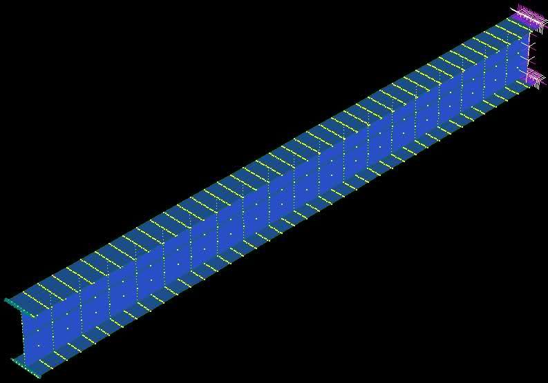

how are you loading this ? (to get non-uniform torsion)
or does the thread header refer to non-uniform torsional stresses ??

Maybe the difference between the FEA results and the theoretical is that the 9 noded element is modelling shear deformation better, resulting in reduced shear stresses.

[cite]how are you loading this ? (to get non-uniform torsion)
or does the thread header refer to non-uniform torsional stresses ?? [/cite]
To simulate the presence of a twisting moment I entered at the end of the beam 2 shear stress applicated in the wings:
tauZX=M/(h*thik)
Then thank to IDS, I think u've found the answer to my question:
"...the 9 noded element is modelling shear deformation better, resulting in reduced shear stresses."
When I come back home I upload the models ;)

how is this a varible torque ?  it sounds constant
RE: Non Uniform Torsion - QUAD4 vs QUAD9
it sounds like you're applying a torque at the free end of the beam ?
if you're only loading the flanges, i'd expect to see a "shear lag" effect as the torque (applied to the flanges) is reacted as first only by the flanges and further along the beam by the entire section.
try some test models to investigate the behaviour of your elements.
