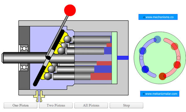

RE: A "new" kind of lightweight/low multi-fuel recip engine.
Have you ever taken apart a variable-displacement piston pump?
Looks pretty much the same inside.
Steven Fahey, CET
And there are lots of hydraulic, hydrostatic motors that look similar to that pump. The main difference between the two is the pump swash plate angle is variable. They must be good for that application since they are constantly immersed in oil.
A swash plate AC compressor, such as a Delco, or Harrison, V7, runs for a long time and is a reliable and effective, and fairly cheap, piece of equipment.
BUT
Its working fluid is cold and non oxidising , and has a lot of oil dissolved in it.
Undoubtedly one can build an IC swash plate engine, they are powerful, smooth, and clever. But they are designed with a life of the order of hours.
