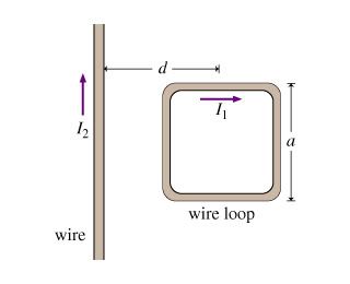

There is a typical problem that I came across in the books is where you have A square loop of wire with side length a carries a current I_1. The center of the loop is located a distance d from an infinite wire carrying a current I_2 . The infinite wire and loop are in the same plane; two sides of the square loop are parallel to the wire and two are perpendicular.
What is the magnitude, , of the net force on the loop?
See the attached photo for description.
I'm trying to use this problem as the basis for solving mine. all the answers I came across so far say that the perpendicular part of the square to the infinite wire cancel out cause of force being in the opposite direction.
What I'm trying to find is how to work out the magnitude and direction of the force in the top perpendicular section of the square.

the origin (0,0) is taken on the infinite wire so that the vector of current J2=j*|J2|, while center of the loop is C=(d, 0);
at distance x from infinite wire magnetic field is a vector
B2(x) = -k*μ0* |J2|/(2pi*x);
♦ take a part of the loop where current J1 is directed from J2; then force on this part is
F3= ∫ |J1|*[dx×B] = j*|J1|*∫B(x)*dx =
= j*μ0* |J1|*|J2| ∫dx /(2pi*x) {x=(d-a/2) to (d+a/2)};
♦ take a part of the loop where current J1 is directed to J2; then force on this part is
F4= -F3;
