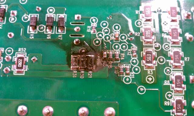

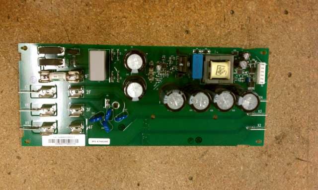

Here's the board that reliably toasts. I included the one meg close-ups only as links.(for those with pathetic bandwidth  LOL)
+1meg link
+1meg link
+1meg link
Just glancing at this it looks like those three resistors are in parallel.   They obviously had a wheee bit much to drink.

RE: ABB Drives Blown Boards.
Looks like they suffered from an MSEE, Magic Smoke Expulsion Event.
