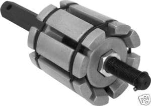

Is there such a thing as a 'radial jack', i.e. a disc that expands radially when actuated?
For example, you could place it in a round hole in an elastic material, actuate it, and it would open up that hole to a greater diameter.
Thanks,
Ed
RE: Radial Jack
Sounds like you're looking for a pipe expander.
RE: Radial Jack
or a mandral like they use to cold work (expand) holes.
is this meant for a one time operation or repeated (if repeated, then probably neither of these suggestions'll work for you).
what's the scale of this ? inches? feet? meters?  if it's really large, then you can visualise a bunch a push-rod actuators arranged round a circle ...
RE: Radial Jack
Cheers guys, the pipe expander was what I was looking for.
The scale was 100mm diameter.
