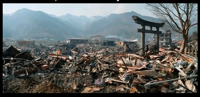

I'd start by checking out what the Japanese made the arch out of:
Nagasaki 1945, after the atomic bomb
Nagasaki 2011, after the earthquake and tsunami
RE: Stonehenge: Could You Make A Monument For 5000 Years Service?
But oh so inaccurate.
You mean the arch is not there anymore?
The good engineer does not need to memorize every formula; he just needs to know where he can find them when he needs them.  Old professor
Don't know about that, but Nagasaki is nowhere near the tsunami location.
No but the tsunami was caused by the earthquake and the caption reads: "after the earthquake and tsunami". So it may not have been hit by the tsunami but by the earthquake?
JMW
www.ViscoAnalyser.com
Not this earthquake.  Nagasaki and Hiroshima are down on the southwest corner of Honshu, which I think is at least 1000 km SW of Tokyo.  The earthquake was northeast of Tokyo.
And certainly, if there was that much earthquake damage, even with the tsunami news dominating the airwaves, there would have been some mention of Nagasaki, specifically because it's Nagasaki.  There would have been mention of some sort of curse, getting flattened by an A-bomb, and then, 66 yrs later, getting flattened by an earthquake.
And, to top that off, there's a blog with the same photos and a different story:
http://blogs.forbes.com/christianwolan/2011/03/15/earthquake-and-tsunami-photos-echo-hiroshima-and-nagasaki/
As a further nail in the coffin, there are pictures of the same type of gate surviving the earthquake in northern Japan, and possibly, the same gate in the other photo:
http://newshopper.sulekha.com/japan-earthquake_photo_1748620.htm
However, there's a example of a similar Torii gate that didn't survive the earthquake:
http://blog.alientimes.org/2011/03/in-the-quakes-aftermath-a-visit-to-some-farms-shrines-and-temples-in-tsukuba/
TTFN
Chinese prisoner wins Nobel Peace Prize
OK but that the arch survived an earthquake should not be surprising. I seem to recall that many of the old temples in Japan and in China were surprisingly sophisticated earthquake resistant structures and a quick Google (how I could have done with google in my youth as an instant adjudicator.... it would have saved countless arguments).
http://en.wikipedia.org/wiki/Japanese_architecture
And the Chinese developed an earthquake sensor that would both sense the event and give some indication of the direction of event.....http://www.ancientchinaculture.com/things/zhang-heng-and-his-earthquake-sensor.html
and http://www.clcillinois.edu/programs/esc/index.asp?seismic
and we should not forget the shaking minarets of Sifahan....http://bbs.keyhole.com/ubb/ubbthreads.php?ubb=showflat&Number=1202984 though as indicated, earthquake resistance is only a supposition.
Wehave to recognise that modern technology does not mean that earlier cultures were not sophisticated. In many cases the label "primitive" is extremely patronising and very inaccurate.
