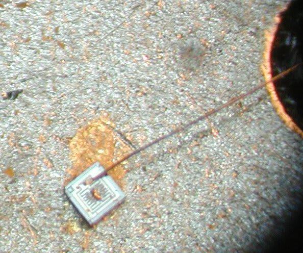

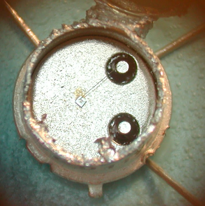

Here's the innards.
Note the missing collector wire(missing with extreme prejudice).
Here's a close up of the die. (all I need is a wirebonder and I can go into transistor repair!)

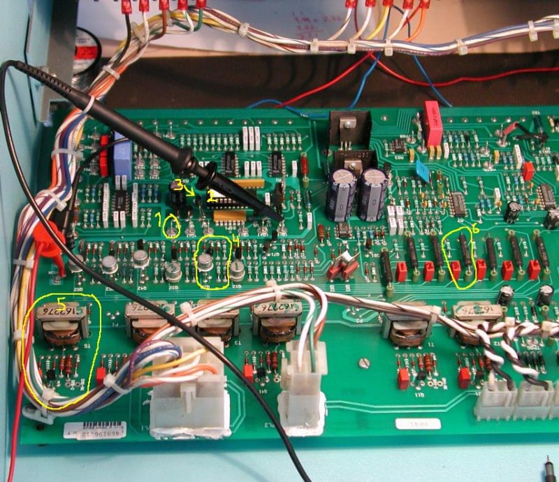

And for everyone's interest here's what the board looks like.
1- Aforementioned test points. Note the scope probe tip bottom right of pic.
2- The sequencer chip.
3- That first transistor in the schematic (top left)
4- A channels drive stack. Pretty much everything in the schematic before the RC-R group.
5- A transformer, the two diodes, and the entire output network for a single channel.
6- The RC-R group.
It's certainly a nice board to work with.

Looking at your photos of the transistor with the lid off, please note it's the emitter wire that has vaporised, not the collector. On the 2N2905A in TO5 package the external collector lead is common to the metal case, and the collector area on the planar die is in direct contact with the case.
In the example photographed, is it possible that you have touched the can of the transistor with the scope ground? That would immediately pop the transistor emitter bond wire as in the photo because it would bypass the R-C network on the collector circuit and thus the transistor would be connected between 28V and ground without any current limiting.

Brian; You're right!  Emitter.  Yes I get it now.
Today I installed the unit back in the furnace and fired it up.   Instantly it was obvious it wasn't running correctly.  It makes a grating dental-drill sound due to nasty harmonics.  I broke out the unidirectional test-lamp. Sure enough one/half channel was missing.
Running the test points showed all the channels running correctly on that side.   So, I ran down the transistor cases. They all showed correct waveforms too.  Right up until I touched the &](^#^#%%@$ case of one with the probe ground-ring, pffft!  That half channel was also now gone.
So yes Brian that certainly does it!
Turned out Fry's carried that transistor.  So in 45 minutes we were back up.  I very, VERY, carefully probed the transistors after wrapping the ground ring in electrical tape.  All channel fine. (Skogs that's the only confirmed time I did it!)
I switched to looking at the final output to the SCRs on the control board.  Every gate was running with 1.4V pulses except one.  It was 7V.
I powered down and unplugged all the outputs.  Powered up and re-measured.  Now all the channels were 7V.   Bingo.
The trigger line was open at the snubber board somewhere.  Where?  Get this..  The terminal block was failed.  The internal pin that connects the flat screw surface to the circuit board was sheared. Sometimes it would make and lately it wasn't very often.  Turned out for that line on that snubber board there was another unused terminal that was paralleled to that same signal.  Moving the control wire to that screw fixed the problem.
